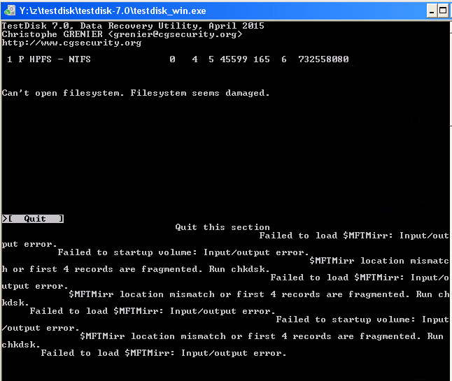

pretty simple... i have a drive with a few terabytes of data. ntfs, no boot, and just files
i was trying to look at some vobs (video files), and for some odd reason, the program that was playing them suddently asked to write to the disk, and before i could think, i hit ok... it did what it did, and the system then hung (i fear a virus)... the disk became not to good.
so, i moved it to a different machine, plugged in the USB, and got to work with your excellent software
i was able to find the boot sector, but an analyse would take way too long...
so i looked to advanced and listed the files and was able to see a recycle.. and a file i created later
but was not able to see the directory with several gigs of movies..
so i eventually tried skipping deep search as the partition was there, it was not with other things, and so i wrote.
this did not work... then tried again, but that was a failure too... eventually i got to the area where one could dump the boot and see... but the only choices it gave me was to overwrite and to rebuild... not restore from the backup...
i ran the rebuild, but did not commit it.

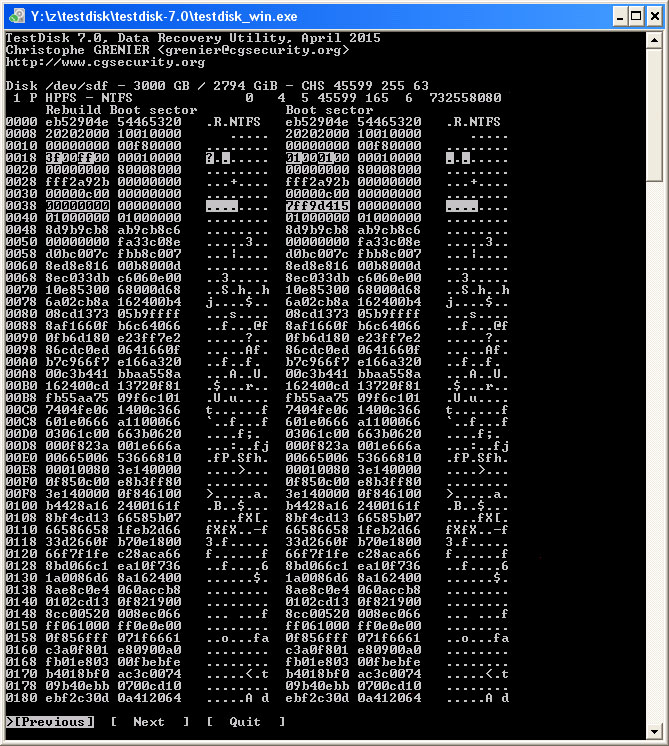

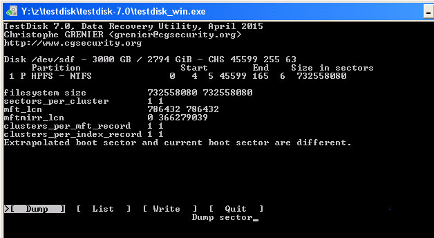

here are some more screens...
here is the dump AFTER the rebuild, but before i hit write (because i am not hitting write till i hear back)

Looks like that your partition table type is Intel.
Might be possible with 4k sectors it might be supported?
Otherwise, Intel MBR supports disks up to 2.2 TB.
The alignement of your partition aren't Intel nor microsoft standard.
That's why you should consider to run a complete Deeper Search.
At least something to try.

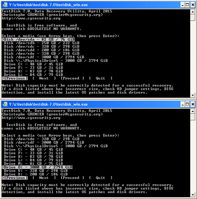

also, when selecting which disk to scan, the disk came up three times, so i included a screen capture of that.
it comes up as
disk 0:\
disk ''.' physical drive 5
and disk /dev/sdf as well
the scan was run against the first one, in case that makes a difference.
