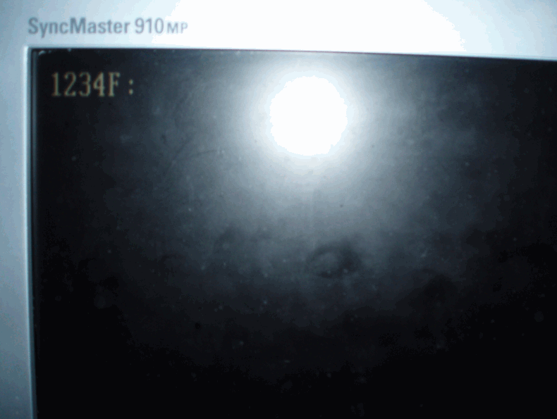

I converted it into the Linux which this tool testdisk recommended big mistake..
Now when I boot I get this error

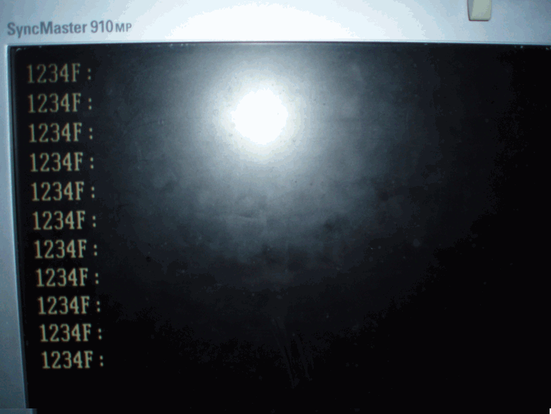

If I press any key on the keyboard I get spammed with that 1234F messages

Re: WD Raid 0 (250GB x2) Bad Boot sector and backup
Posted: 07 Sep 2015, 06:37
If no partition is marked as boot, MBR code from TestDisk will display "1234F", so you can choose between the 4 partitions.
