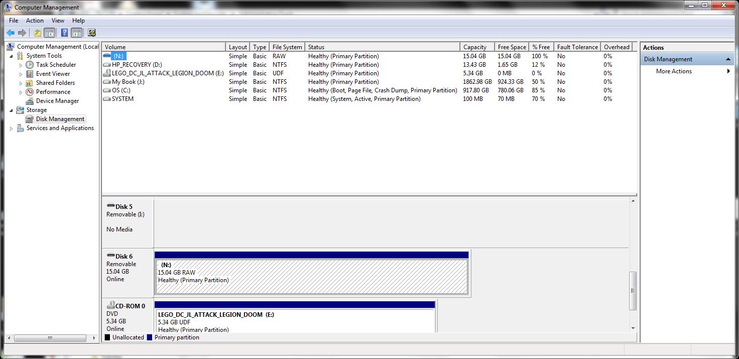

A drive letter is assigned but the file system is listed as raw. Windows see's the USB key and gives it a drive letter, however when I try to recover the data off of it neither Testdisk or PhotoRec lists this device as something to recover from.
I have tried uninstalling the device from my device manager, and also ejected the media properly a few times with no luck.
Is there any way I can make it visible in photorec to recover the lost files?
Here is screenshot of where I'm at.

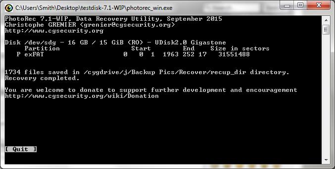

Re: USB drive not recognized by testdisk
Yes, this is the only drive that is missing.
I have attached the a capture of the list of drives that it gives me on the startup screen. Its the same for TestDisk.
This PhotoRec session was run as Administrator.
- Photorec.jpg (49.61 KiB) Viewed 16720 times
Can you try using latest 7.1-WIP ? If it still doesn't work, please run "testdisk_win /debug /log /all" and post the testdisk.log fle content.
This worked perfectly. I ran 7.1 and it was right there. I got all my files back.cgrenier wrote:Can you try using latest 7.1-WIP ? If it still doesn't work, please run "testdisk_win /debug /log /all" and post the testdisk.log fle content.
