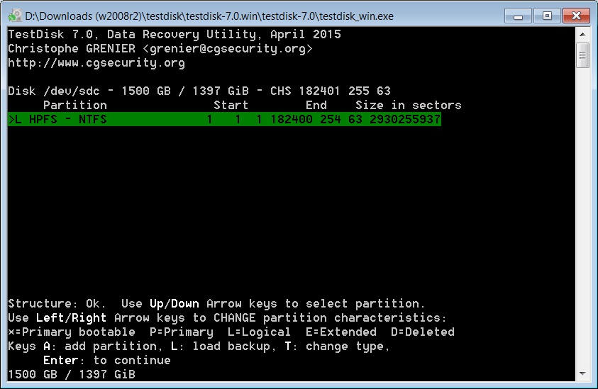

(1) Disk was detected and I did 'Quick Search'. The partition showed up in green.

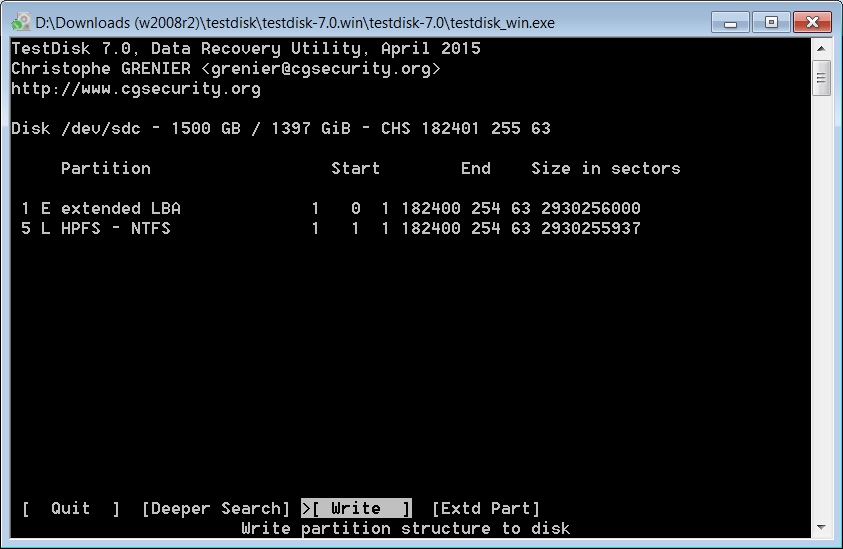

(2) I pressed 'P' and the next message says "Can't open filesystem. Filesystem seems damaged."

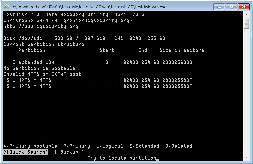

(3) So I went back to green screen and press 'Enter', followed by 'Write'. On reboot still can't access.

- This was detected and I did 'Quick Search'
- testdisk-1.jpg (110.37 KiB) Viewed 2440 times
- I pressed 'P' and the message says "Can't open filesystem. Filesystem seems damaged."
- testdisk-4.jpg (112.06 KiB) Viewed 2440 times
- So I went back to green screen and press 'Enter', followed by 'Write'. On reboot still can't access.
- testdisk-5.jpg (90.1 KiB) Viewed 2440 times
Re: Accidentally did Quick Format ... HELP!
You already have your partition in your partition table.
That's why writing it again into your partition table doesn't help.
In your case a complete quick format would override your file system, boot sector and cause an empty file system.
But your partition appears as RAW and means, file system or boot sector are damaged or not available.
Have another try to run TestDisk / Advanced, select your partition, confirm with Boot and run a RebuildBS.
When it's succesful, go to the menu List and have another try to list your files.
