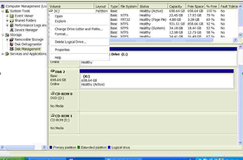

Hi, I have no "file system" showing for my "K" external drive.
When right click it, it only has option for "Mark Partition As Active" - there is no " initialize your disk" available to utilize.
Do these terms mean the same thing (activate and initialize)?

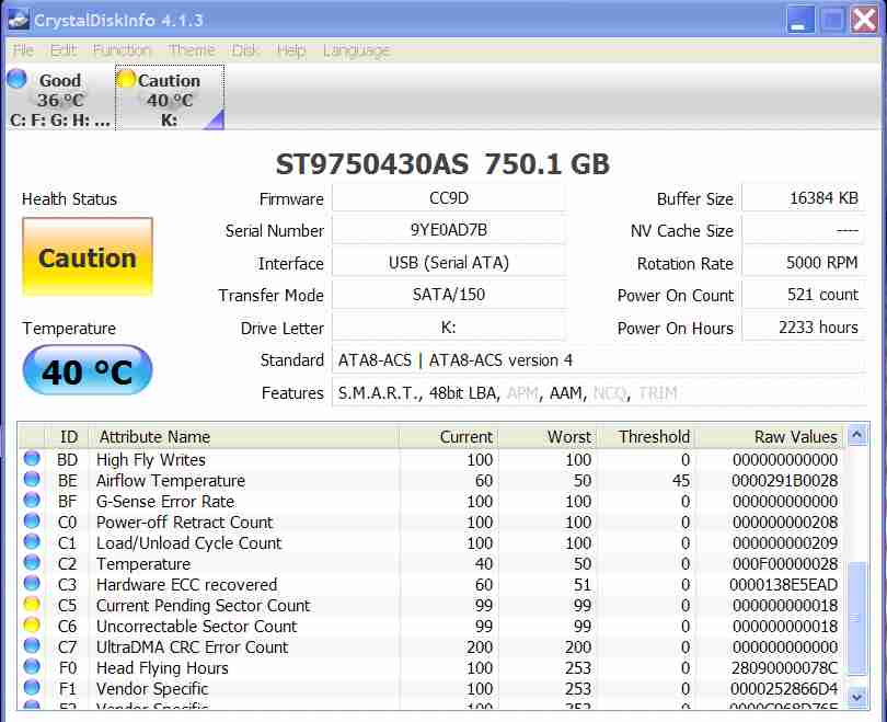

Crystal Disk is reporting the disk as YELLOW caution and >
Current Pending Sector Count C5 is YELLOW
Count of "unstable" sectors (waiting to be remapped, because of read errors). If an unstable sector is subsequently read successfully, this value is decreased and the sector is not remapped. Read errors on a sector will not remap the sector (since it might be readable later); instead, the drive firmware remembers that the sector needs to be remapped, and remaps it the next time it's written.
Also - Uncorrectable Sector Count C6 is Yellow
The total count of uncorrectable errors when reading/writing a sector. A rise in the value of this attribute indicates defects of the disk surface and/or problems in the mechanical subsystem.
Is there yet hope for any recovery? How do I proceed ? Thank you, for all and any suggestions!

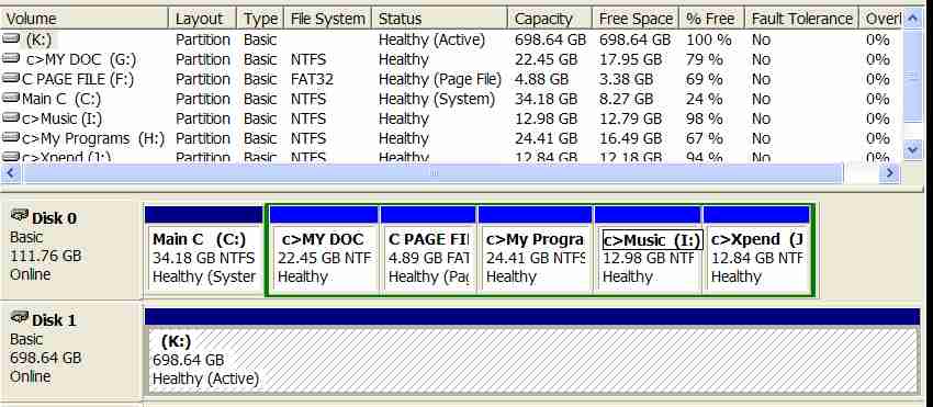

In case, you can upload a screen from your disk manage,ment console.

Hi Fiona, I like your name and your avatar... :)
I can't give images till tomorrow. but I can tell you that I have a 750 gig Seagate expansion external harddrive that was half full.
My computer automatically checked the disk and some how the partition is no longer available and I am being told that there is a "device i/o error"... And my file system is missing.
The drive is "K" that went from being NTFS to RAW... :cry:
I am hoping with your kind and gentle help to restore the partition to its normal state so the data can be recovered in full.
I'll start trying again in the morning, Thank you for responding - ducklip... :D

Good morning Fiona - Please direct my next move, I will follow your help - Thank you!

Hope these help solve this problem?

NO "initialization" was not done to the disk...In my computer management on XP it is not as option when I right click it.

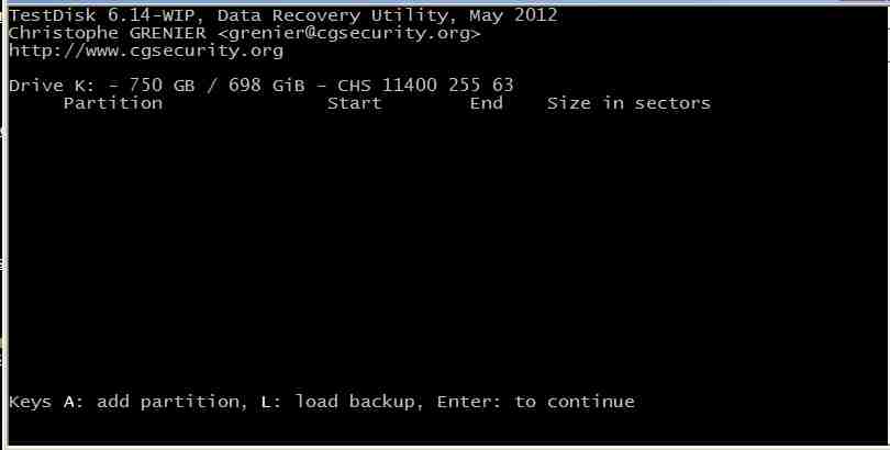

TestDisk displays your disk as drive.
It does show option as DISK in the beginning of the process...
capture
capture

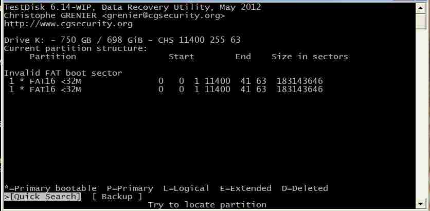

Fiona wrote:Please have a try to select your disk instead of a drive.
I chose DISK, "analyze" and this is my this is a description of my "current partition structure" with TestDisk.
Currently your file system appears as FAT16.
I assume it's wrong.
Correct Fiona, it was "NTFS"

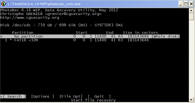

I should bring to your attention that when I use "Photorec" and choose DISK then PROCEED it shows that a No Partition {Whole Disk} is available...
this is a description of my "current partition structure" with Photorec...
