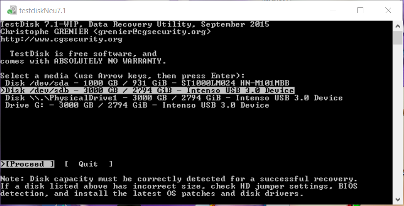

#4 Post by Fiona »
No, there is no necessity to run your windows explorer.
After starting TestDisk, the first display is log file creation.
Pressing enter takes you to your disk selection.
At this display you should select your affected Disk instead of your drive.
You can watch it here as an example:
My selected Disk is "Disk /dev/sdb".
It's my Intenso USB 3.0 Device.
The last Device is Drive G: and also my Intenso USB 3.0 Device.
At this display you should select your Disk and not your Drive.
