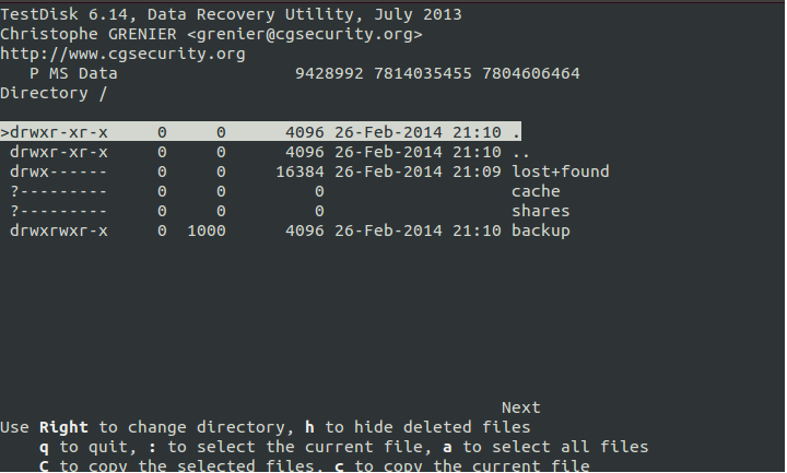

Hope to have your help on how to use testdisk. I need to access the "shares" folder as can be seen in the attached screenshot.
I was able to write the partition table using testdisk but I just can't access the "shares" folder. I after recovering the partition, I tried running fsck on the image file and was quite successful enough as it allowed me to mount the partition but still I can't access the "shares" folder. Please give me some thoughts on how to do it. Thanks.

Can yoy try using TestDisk 7.1-WIP ? It contains a more recent version of libe2fs
