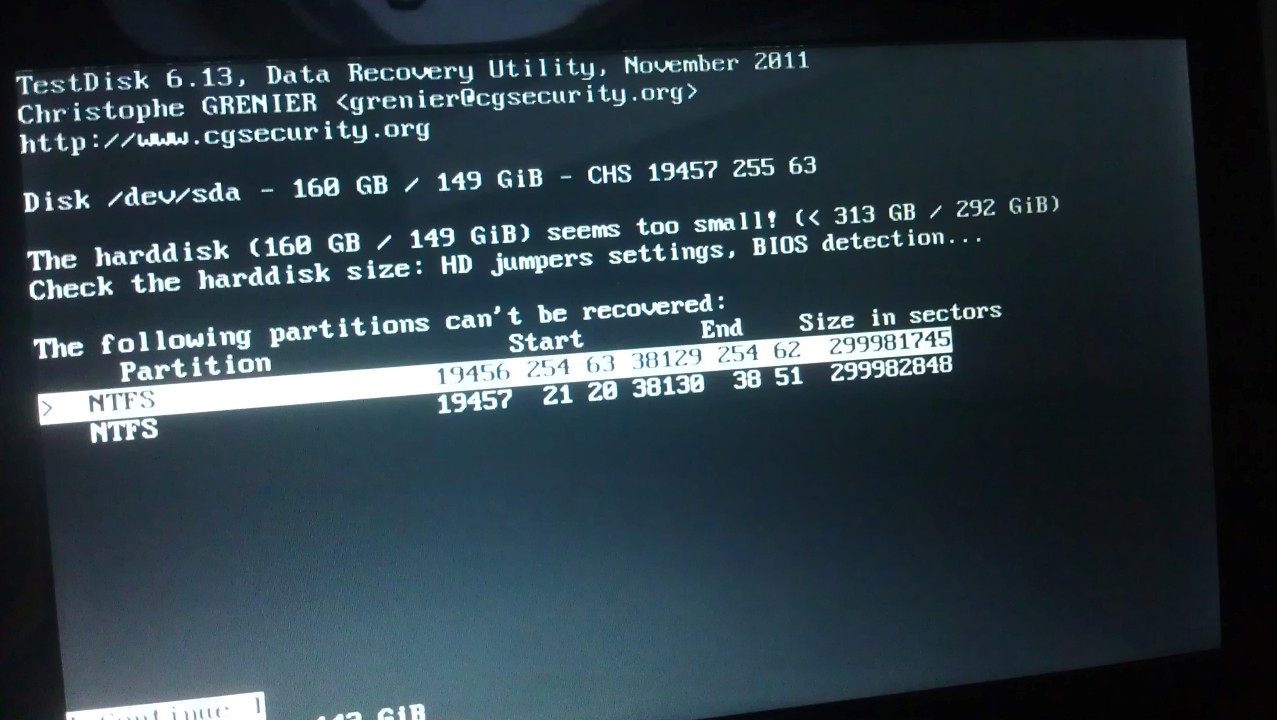

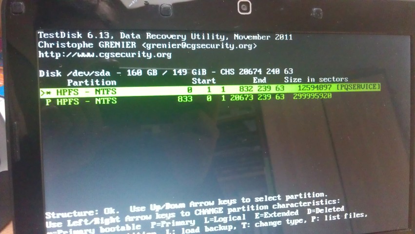

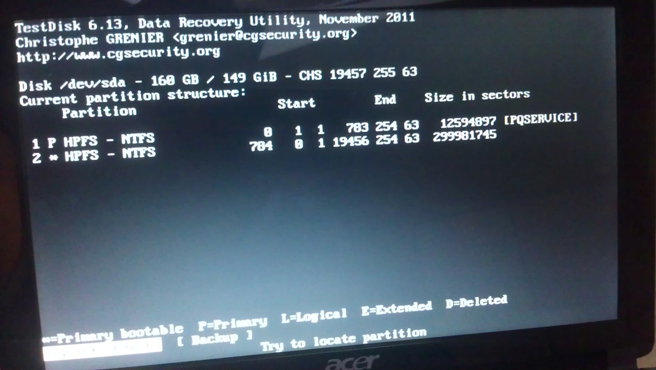

Thanks Fiona, attached are some photos of different results.
I'm not sure what you mean by 'how your disk is listed', I hope the attached files do show the required information.

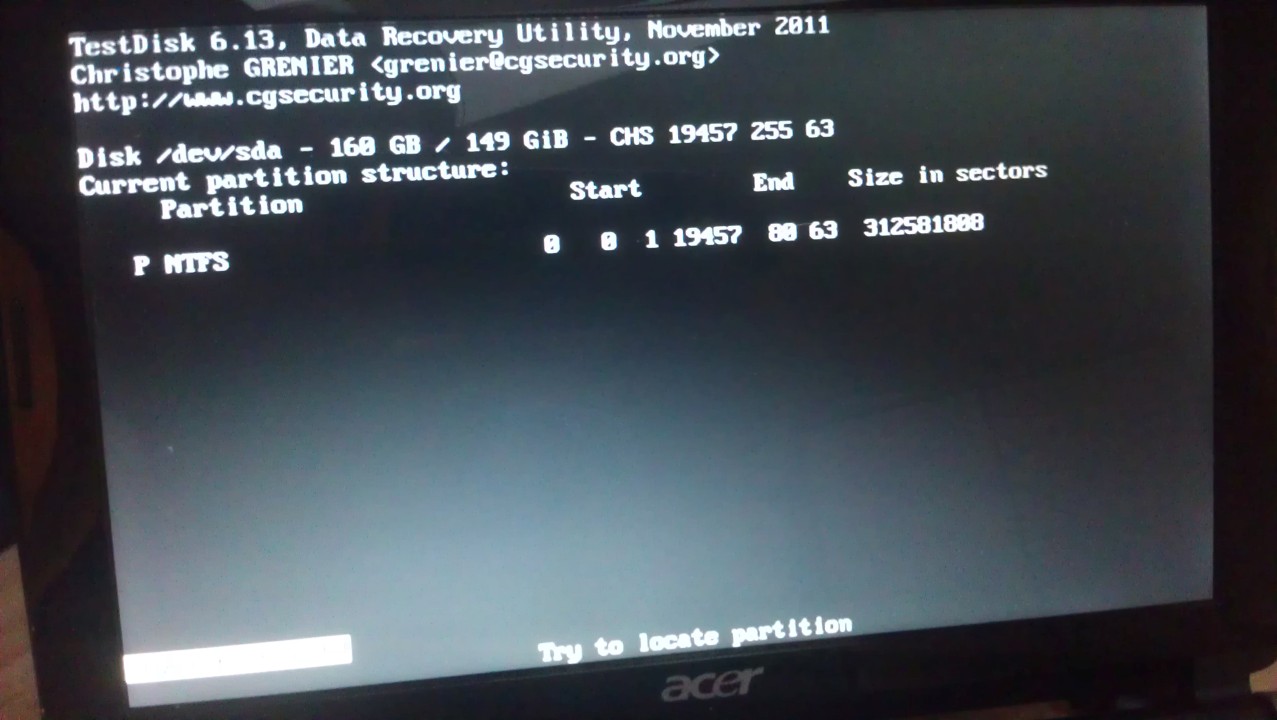

Re: Partition found table type None, but not using NTFS
Here are two more images, in addition to the previous post.
- 5-None-deep-result.jpg (235.97 KiB) Viewed 23278 times
- 4-None-quick-result.jpg (173.89 KiB) Viewed 23278 times
On this screen;
http://forum.cgsecurity.org/phpBB3/down ... .php?id=42
Your Acer-partition is listed.
Did you try to list your data and from that partition above too?
As far as I've seen, your partition table contains one partition using the complete space.
Your PQService partiton doesn't matters at the moment.
It'll be considered when your acer partition is found correctly.
I have tried listing files for the PQSERVICE and ACER partitions, in different results.
Whenever the name was properly found, I was able to list the files.
In the result you linked to I have also tried listing files on the partition just above the one with the [ACER] label.
The files can't be found on that partition.
(Though on the one with label, they can)
Sorry if I was unclear at first.
I can list my files on every partition with a proper label (checked for ACER and PQSERVICE).
So that would be PQSERVICE with
- NTFS - Quick Search
- None - Deeper Search
And ACER (the one with the label) on image 5-None-deep-result.jpg, start [784, 3, 52], only with None - Deeper Search

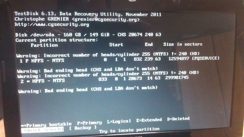

(Before, when mentioning table type NTFS type, I should've mentioned Intel as partition table type.)
Using partition table type Intel, and changing the Heads to 240 in geometry, these are the results.
I still can browse the found PQService partition, but not the other one.
When starting the Quick Search or the Deeper Search I also get a warning
"Warning: the current number of headers per cylinder is 250 but the correct value may be 255. You can use the Geometry menu to change this value. (...)"
Analyse Quick Search Deeper search
