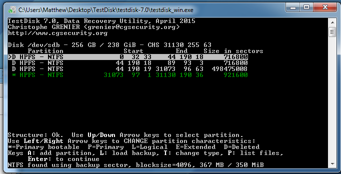

I have an Asus Zenbook which was only booting into the bios, It was dropped and I believe the SSD may have come loose from the fixing.
I made a bootable USB but none of the windows repair options would work (I got messages saying the drive is locked). After some research I decided to plug the drive into my desktop machine and run test disk to try to fix the issue. I already performed data recovery and my files are there but they all come back in small parts/non named/mixed up so its not really that useful. I'm hoping to be able to restore the full machine with its file-system intact.
The test-disk quick analysis shows up nothing so I did the deep scan and I get the below. The first partition lists some files when I hit p, looks like some boot files, all the others say "Cant open filesystem, filesystem seems damages"
I am thinking the fact that the first partition does not start at 0 1 1 could be a problem but I don't know how to fix this?
If I go into advanced settings it says "no partition avaliable" and there are no other options to try. I read something about the "Write MBR code" but I don't really know what this is so I dont want to mess it up!
Thanks for your help :)

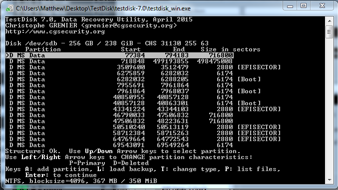

I have rerun the scan with the "EFI GPT" setting, takes a lot longer but it does find some things with the quick scan, I am fairly lost with what this output means however so any help would be much appreciated.
Please note I had to edit out some of the repetitive parts of the log file due to the 6000 character limit.

file_pread(5,1,buffer,505488383(31465/50/9)) lseek err Invalid argument
NTFS: Can't read MFT
     MS Data                499193855  997668862  498475008
     NTFS, blocksize=4096, 255 GB / 237 GiB
This partition ends after the disk limits. (start=499193855, size=498475008, end=997668862, disk end=500118192)
NTFS at 31130/190/36
filesystem size           921600
sectors_per_cluster       8
mft_lcn                   38400
mftmirr_lcn               2
clusters_per_mft_record   -10
     MS Data                499193856  500115455     921600
     NTFS found using backup sector, blocksize=4096, 471 MB / 450 MiB
mft_lcn                   38400
mftmirr_lcn               2
file_pread(5,1024,buffer,500425727(31150/15/33)) lseek err Invalid argument
file_pread(5,1,buffer,500425727(31150/15/33)) lseek err Invalid argument
     MS Data                500115455  501037054     921600
     NTFS, blocksize=4096, 471 MB / 450 MiB
This partition ends after the disk limits. (start=500115455, size=921600, end=501037054, disk end=500118192)

Disk /dev/sdb - 256 GB / 238 GiB - CHS 31130 255 63
The harddisk (256 GB / 238 GiB) seems too small! (< 510 GB / 475 GiB)
     MS Data                    77384     794183     716800
     NTFS, blocksize=4096, 367 MB / 350 MiB
     MS Data                   718848  499193855  498475008
     NTFS found using backup sector, blocksize=4096, 255 GB / 237 GiB
     MS Data                  3509600    3512479       2880 [EFISECTOR]
     MS Data                  6275859    6282032       6174
     MS Data                  6282032    6288205       6174 [Boot]
     MS Data                  7955691    7961864       6174
     MS Data                  7961864    7968037       6174 [Boot]
     MS Data                 40850955   40857128       6174
     MS Data                 40857128   40863301       6174 [Boot]
     MS Data                 43341224   43344103       2880 [EFISECTOR]
     MS Data                 46790033   47506832     716800
     NTFS found using backup sector, blocksize=4096, 367 MB / 350 MiB
     MS Data                 47506832   48223631     716800
     MS Data                 50510240   50513119       2880 [EFISECTOR]
     MS Data                 58712384   58715263       2880 [EFISECTOR]
     MS Data                 64769664   64772543       2880 [EFISECTOR]
     MS Data                 69543091   69549264       6174
     MS Data                 69549264   69555437       6174 [Boot]
     MS Data                 70617451   70623624       6174
     MS Data                 70623624   70629797       6174 [Boot]
     MS Data                 78138339   78144512       6174
     MS Data                 78144512   78150685       6174 [Boot]
     MS Data                 95274211   95280384       6174
     MS Data                 95280384   95286557       6174 [Boot]
     MS Data                210291771  210297944       6174
     MS Data                210297944  210304117       6174 [Boot]
     MS Data                272702555  272708728       6174
     MS Data                272708728  272714901       6174
     MS Data                379789684  379792183       2500 [IÄ†¯f’5VB¤ì›¤]
     cramfs, 1280 KB / 1250 KiB
   P MS Data                499193856  500115455     921600

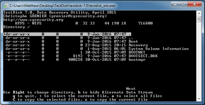

dir_partition inode=0
       2 drwxr-xr-x     0      0         0 29-Oct-2015 13:49 EFI
dir_partition inode=2
FAT: cluster=2(0x2), pos=3509633
Directory /EFI
       2 drwxr-xr-x     0      0         0 29-Oct-2015 13:49 .
       0 drwxr-xr-x     0      0         0 29-Oct-2015 13:49 ..
       3 drwxr-xr-x     0      0         0 29-Oct-2015 13:49 BOOT
Directory /EFI
Directory /EFI
Directory /EFI
Directory /EFI
       0 drwxr-xr-x     0      0         0 29-Oct-2015 13$MFT has invalid magic.
