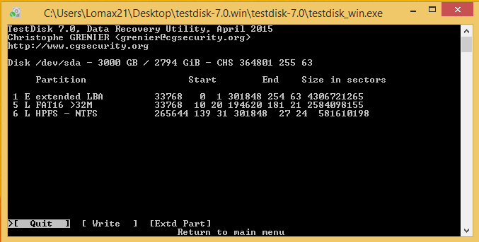

So this is very strange. I have a 3TB external seagate drive that the USB3 dock thing flaked out and the drive was starting and stopping before finishing it routine.
I swapped cases and the issue was the same thing. Windows sees the drive but wants it formatted. Disk management also sees the drive and claims there are now 2 new partitions, 3 in total. One is RAW the other 2 are just Unallocated.
I ran Testdisk and did the quick search and it came back saying it found an invalid FAT32 partition info, so I did the deep scan and about 6-7 hours later it found all 3 partitions and seems to say two are FAT and one is NTFS.
I've been through all kinda HDD problems from just losing the FAT tables all together to corrupted MBR/MFU's etc, but I've never seen something quite like this.
I guess the real question is should I just delete the partitions and try to rebuild? There is about 2TB of info I need to get back, some is backed up some not so I'd like to get as much back as i can.
Drive was not partitioned but now has 3?!
- This was the finale output of the deeper scan
- Capture.PNG (15.31 KiB) Viewed 3237 times

Any insight on this guys? I'm pretty sure I'm gonna need to go grab another drive to attempt to move the stuff off, but are the file names gonna be messed up with the file tables all screwed up?
