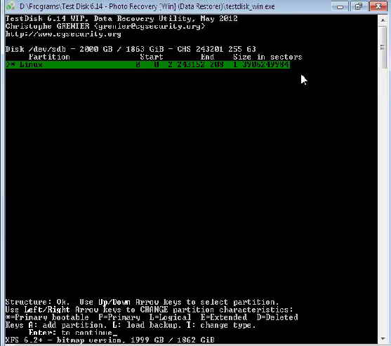

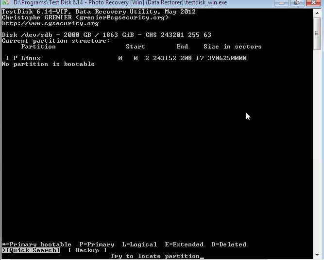

I am pretty sure that my case is DISK1=DISK2=Space. I had few important pictures so I ran Photorec for .jpg on both drives and it gave me similar results. I saved recovered files to DISK3, not to harm data on first two.
Here are pictures of results you asked
Disk1 current.jpg (24.91 KiB) Viewed 12329 times
Disk1 quicksearch.jpg (23.65 KiB) Viewed 12329 times
Disk1 deepscan.jpg (30.26 KiB) Viewed 12329 times

It seems you had 2 times 2TB in raid1, and partition wasn't recreated. Only filesystem reformat :( The worse, with XFS+.
I think your best chances are to use Photorec, there...
