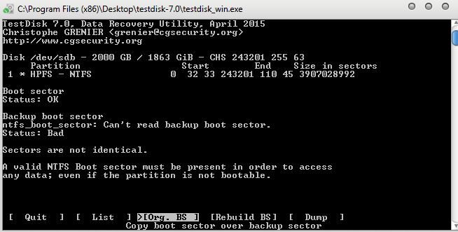

this is the latest report.
- This is the latest report since testdisk identified my hd as INTEL.
- Capture.JPG (50.61 KiB) Viewed 11061 times
Re: None Partition type detected by TestDisk
My bootsector is OK
Backup bootsector is BAD.
Sectors are not identical.
I tried to rebuildBS. Still the same. Try to Write. And still the same. Tried chkdsk under admin rights, it just stuck for a lifetime with black screen of the command prompt with '-' blinking.
I can see my files under List. But not all the files were shown.
Is there any other method i can use?
Your partition is probably larger than the disk, it's why TestDisk failed to read the backup boot sector and it can also explain why chdsk doesn't work.
You can try to reduce the partition size.
It's recommended to copy the files you can access using TestDisk first.
Run TestDisk, Analyse, Quick Search, using the arrow keys, set the partition found by TestDisk as D(eleted)
use 'a' to manually add the partition HPFS-NTFS 0 32 33 243200 255 63
Set this partition as *(bootable).
On next screen, choose Write, confirm.
Go in Advanced, Boot, RebuildBS, List. If you can see your files, choose Write and confirm.
Quit and reboot your computer
Try again "cmd" as administrator and "chkdsk /f d:"

So I followed all the steps that you suggested me to do. And finally i got the result (see first attachment below).
and then i reboot my computer. waiting for it to start.. and run chkdsk under admin rights. and still. no signs of hope yet. it still stuck at the blinking '-' (see second attachment) with this i attached my testdisk log file.
