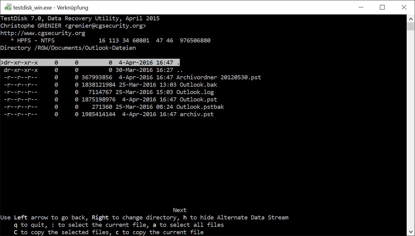

thank you very much for your reply. I had a "copy all files" task running, in order to save at least what I can recover at the actual state, and this has just been terminated right now so I now have access to the data again.
It seems that file size is always different, with no constant factor. Some files with originally 100kb are copied with slightly more than 200kb, bigger files are copied with very much less bytes, please refer to the following example screen shots.
File listing Testdisk.jpg (102.87 KiB) Viewed 8021 times
File listing copies.jpg (123.32 KiB) Viewed 8021 times
I also tried if only the most recently changed files are altered because of an uncompleted write-to-disk action in the moment when the problem occured. But this is not the case. Even files that I did not access for years copy with different size (some smaller, some bigger).
Only very small files (about 1kb or so) copy with their original size.
Maybe this is due to choosing "Intel" as file table type instead of the default "EFI GPT". But with EFI GPT quick search didn't work, as mentioned before.

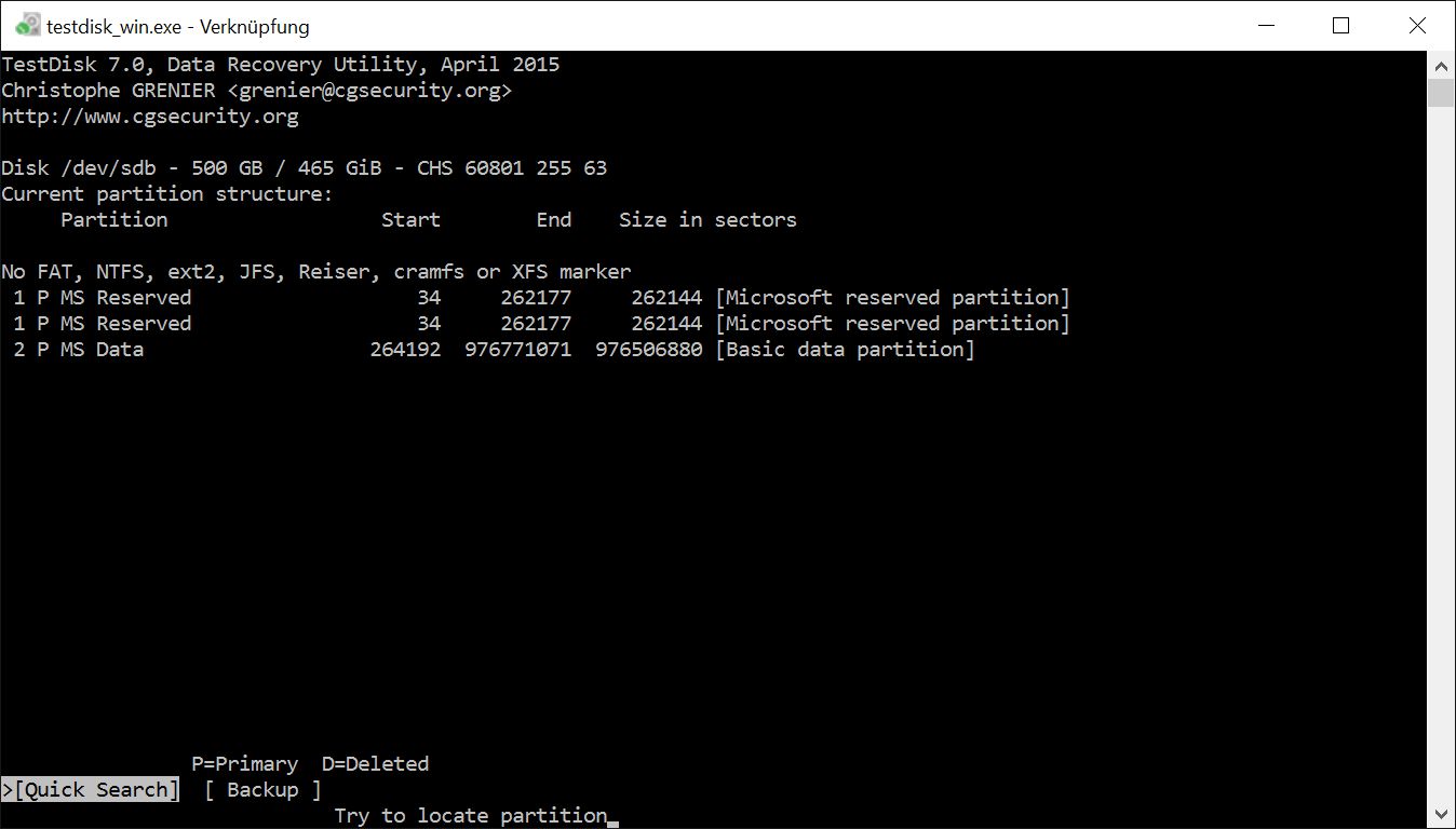

In the meantime I got somewhat further:
"Analyze" the 500GB HDD with "EFI GPT" as type of file table finds (as already before) these partitions:
EFI GPT Partitions.jpg (76.51 KiB) Viewed 8014 times

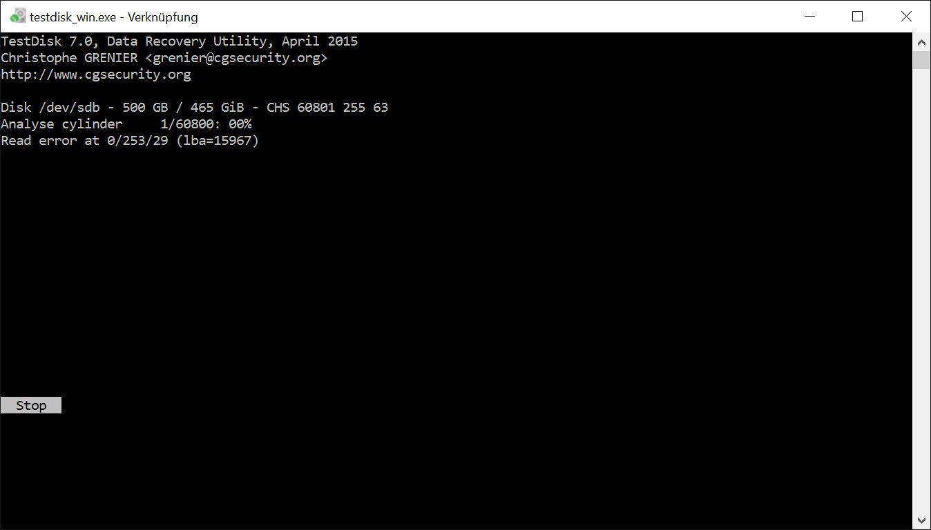

"Quick Search" then results in the following "Read Error":
EFI GPT read error.jpg (45.1 KiB) Viewed 8014 times
Is there anything I can do?
Thank you in advance for answering!

Re: File recovery from broken NTFS partition
#6 Post by cgrenier »
Clone your disk using gnu ddrescue to a new empty disk
https://www.cgsecurity.org/wiki/Damaged_Hard_Disk
Once it's done, remove the original disk and try to recover your data from the clone
