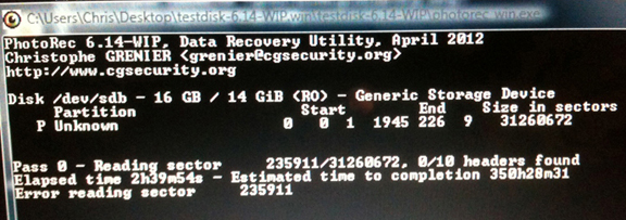

Hello, I was using a 16GB SD Card on a trip when it stopped working the last day and now none of the photos can be accessed. If I load the SD card into the built in card reader in a PC or MAC in won't mount or be recognized. When I use a card reader along with PhotoRec, it will show that there is a 16GB card, but I keep getting "Error reading sector" throughout the scanning process. Any help would be gladly appreciated! I have attached a photo of the screen scanning in progress.

Try with various card readers but it doesn't look good.

Thanks Grenier. So far only one card reader out of 4 was able to get the sd card to be recognized by the PC. It was very funky, I was shooting one second with my Canon dslr, and the next second I get an error message.
Would formatting the card help the recovery process? Or would that make things worst?
