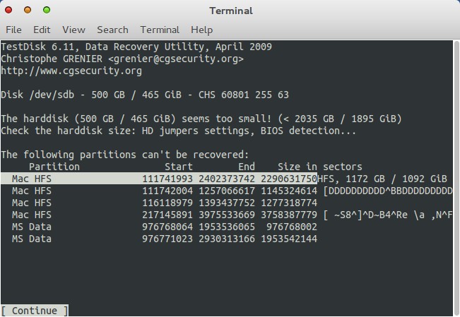

Added a picture of what shows up when I run it as GPT search rather then Intel, gives more results but some look strange.
All of them in deeper analysis search say - Filesystem seems corrupt cannot show files etc.
Any suggestions what to try?
- Terminal_001.jpeg (58.5 KiB) Viewed 15990 times

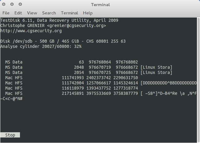

Re: This partition could not be recovered, size does etc
This happened at the end, really do need some advice on this.
- Terminal_002.jpeg (68.78 KiB) Viewed 15985 times
Would it be possible to repeat your diagnose in windows
If you didn't have an GPT-partition then there is no necessity to diagnose your disk using GPT.
Did you check it and press p to list your data?
Could you repeat your diagnose as far as possible and copy and paste the content of your testdisk.log in your post?
You'll find the testdisk.log in your testdisk foilder and you can open it using wordpad.
Would need more infos about your NTFS-partition.I ran teskdisk and got the error message from the title but it has found the partition which is NTFS.
