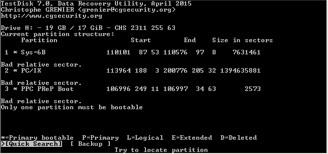

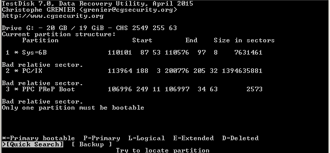

The First recovered Partition [G] (an old Win XP bootable Partition size 20 GB ) appears as RAW in DataStorageManagement of Windows 7. It appears in the "Computer" Secton, but is not accessible. The second recovered Partition [H] is shown as "100% functional" and is shown in "Computer" section and is 100% nicely accesible (It was a 20 GB storage PArtition, non bootable')
When entering analyze menu subpoint in testdisk, it shows:
[Screenshot1] for the first partition [G] in INTEL MODE (not searched yet)
-after Search and Deepsearch, the list just stays EMPTY, no partitions found.
[Screenshot2] for the second partition [H] in INTEL MODE (not searched yet)
One Partition [H] is working, but both show the same weird Partition List in the beginning of ANALYZE Menu ? And no results after Searches? How is that possible..

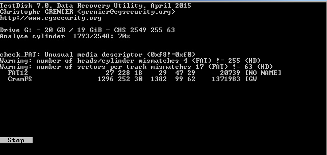

So I Quick Searched the First Partition [G] in ANALYZE MENU but this time NONE MODE
[Screenshot3] show what happened during the search
[Screenshot4] And after it
I can now access the File List of first Partition [G] , looks good. But how can i restore the MBR or Partition Files now, in order to make that partition work in Windows and maybe make it even bootable again? It says the NTFS backup is alive, so this should be possible, right? But all the write tools don`t work in NONE MODE right?

Re: Weird partition fragments in the Analyze List, zero partitions found after deep search
Why are you searching partitions inside partition ? It's useless.
Run TestDisk, select the physicaldisk, Advanced, for each partition, Boot, RebuildBS, List. If you can see your files, choose Write, confirm, Quit.
