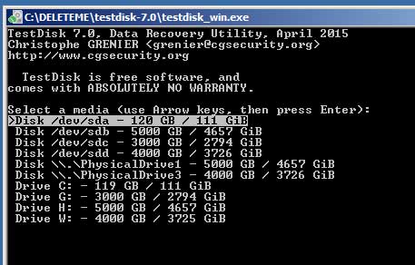

I am new here, using for the first time this amazing program called TestDisk.
I am asked by the program to select a media.
But I see the same disk (the 4GB disk) shown here 3 times.
So I am curious, what is the difference between the options
Disk /dev/sdd
Disk \\.\PhysicalDrive3
Drive W:
Please check the screenshot
Disk /dev/sdd or Disk \\.\PhysicalDrive3 or Drive W: ???
- Testdisk1.jpg (26.78 KiB) Viewed 4671 times
Re: Disk /dev/sdd or Disk \\.\PhysicalDrive3 or Drive W: ???
Use TestDisk 7.1-WIP, you will get the disk description.
W: is a single partition. It's better to use /dev/sdd or PhysicalDrive3 but I don't know why it's listed twice.
