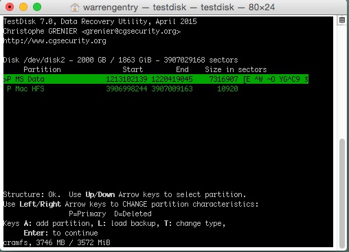

Ok the new scan has completed and here is the current window. This is where I messed up last time by really not knowing what to do next. How do I proceed.

Just looking for a little guidance on this issue. Thanks!
