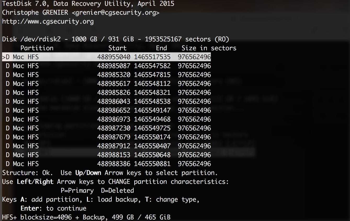

Then I've run "Deep Search", this time it found thousands of deleted partitions whose sector sizes are the same but start/end values are shifted by some margin.
And because the partition that I want to save is an HFS partition, I can't try using "list" option and detecting which of the listed partitions will show the file list.
How can I detect which of the partitions is the true one?

Re: Deep Search shows tons of deleted partitions
To find the correct HFS+ partition, you should try the partition where "+ Backup" is listed on the last line of the screen when highlighted.

Thanks for the fast response!
So I'll move with the following partitions:
>P EFI System                    40     409639     409600 [EFI] (Which can list files via "p" button)
>P Mac HFS                   411648  488692895  488281248 (HFS+ blocksize=4096 + Backup, 249 GB / 232 GiB)
>P Mac HFS                488955040 1465517535  976562496 (HFS+ blocksize=4096 + Backup, 499 GB / 465 GiB)
>P Mac HFS               1465779680 1758486527  292706848 (HFS+ blocksize=4096 + Backup, 149 GB / 139 GiB)
>P MS Data               1758748672 1953523711  194775040 (exFAT, blocksize=131072, 99 GB / 92 GiB) (Which can list files via "p" button)
Changing these from Deleted to Primary and then continuing would be enough right?

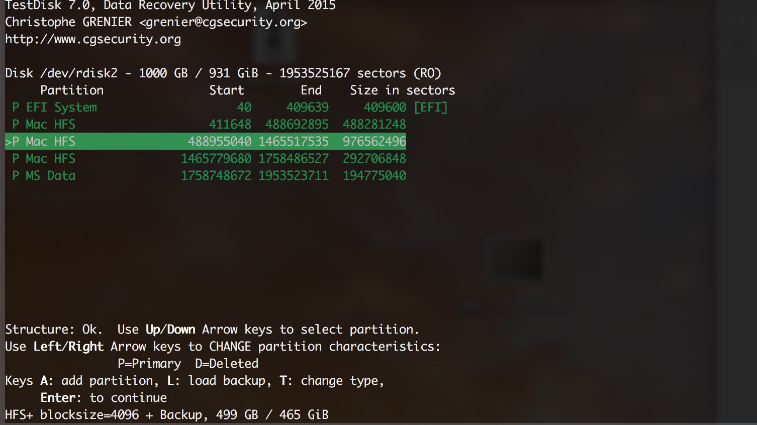

I've tried to write new partition table but write failed with "write error" message.
By the way, I see that the above partition table which I selected from deleted partitions seems to be exactly the same with current partition structure, which is the folowing:
 1 P EFI System                    40     409639     409600 [EFI System Partition]
 2 P Mac HFS                   411648  488692895  488281248 [Apple_HFSX_Untitled_2]
 3 P Mac HFS                488955040 1465517535  976562496 [TimeMachine]
 4 P Mac HFS               1465779680 1758486527  292706848 [MacMini]
 5 P MS Data               1758748672 1953523711  194775040 [windows]
What should I do to be able to correctly write deleted partition and reach the files?

Hi again,
I had to run a Deeper Search from scratch. Here is the full log file :
testdisk.log.zip
(53.55 KiB) Downloaded 668 times
Is it possible to switch only one partition from deleted to primary? I really need to save only one partition, namely the following (most probably):
HFS+ magic value at 1465517534/0/1
part_size 976562496
     HFS+ found using backup sector!, 499 GB / 465 GiB
which has the same Start/End sectors with the current partition table:
How should I continue now? Would switching only the above partition work without switching EFI System to primary?
