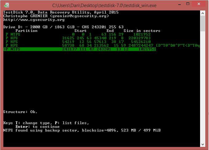

My question is have i damaged my MFT? and should I follow these instructions below?
run test disk,
choose advanced menu
select my NTFS partition
choose boot
then repair MFT
I've added some screen grabs below and some background info on what I did:
I damaged my portable usb drive, I accidentally set it as a destination for a clone backup! Literally only for a second though, I realized my mistake just after pressing the button to start the process then I hit cancel.
Now when I try to access the disk windows says the filesystem seems damaged, the chkdisk utility didn't fix it either.
I'm on windows 8, the drive is an external usb portable drive.
Anyway I run test disk, it did an analyse and listed some things in green:
Trouble is I don't know what this means. I'm scared of damaging the data even more by picking the wrong options.

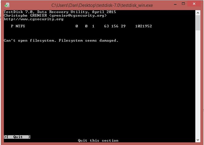

This what testdisk syas after pressing p to list files:
Thanks for reading, I'm a novice so any help will be really appreciated.
Re: MFT damage
Select the PhysicalDrive containing D: instead of D: directly.
Advanced, Boot. If the main boot sector is damaged, choose BackupBS and confirm, Quit and restart your computer.
Use TestDisk 7.1-WIP, it is better as repairing the MFT than previous versions. Try it only if the boot sector is already ok, if Windows can not access your files and TestDisk failed to list your files.
Please post the testdisk.log file content if you have problems.

Hi thanks so much for the reply,
When you say "Select the PhysicalDrive containing D: instead of D: directly", do you mean the select the drive at the earlier Disk selection menu or one of the other green entries listed in my first screen grab? Apologies if this is obvious!
Can I just check, would my drive have a boot sector? It wasn't used to run an OS from just as an external drive, do all drives have boot sectors?
I'll install 7.1
Thanks again for your help,
Cheers

I used testdisk 7.1, it said boot sector ok and is identical to backup boot sector. It also said MFT and MFT mirror match perfectly! But the file system is still damaged.
Is this the end of the road for me or is there something I can do to repair the file system?
I noticed the log mentione the '$MFT has invalid magic'. I'm not sure what that means but seems relevant.
Cheers,
Dan

I just tried the same thing back in testdisk 7.0 and it says something different to 7.1 it says 'MFT and MFT mirror are bad.Failed to repair them'.
