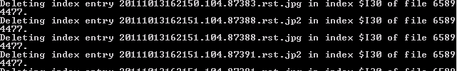

Unfortunately it is not like that. Windows says that it cannot see anything on the drive.
Chkdsk – can see partition name it san see that the file system is NTFS. It also can see some files and pretends that it is deleting some of indexes (every run it “deletes” the same files)
