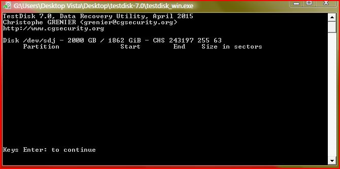

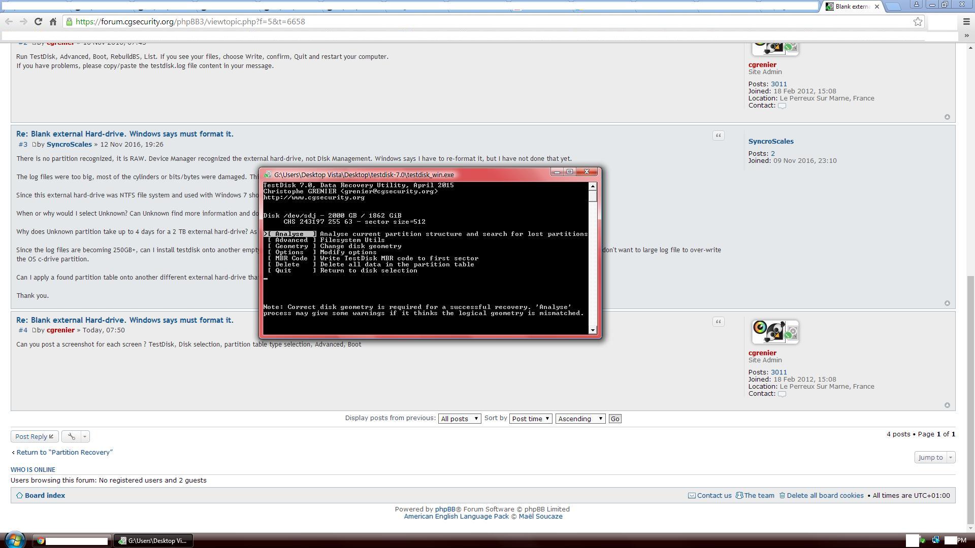

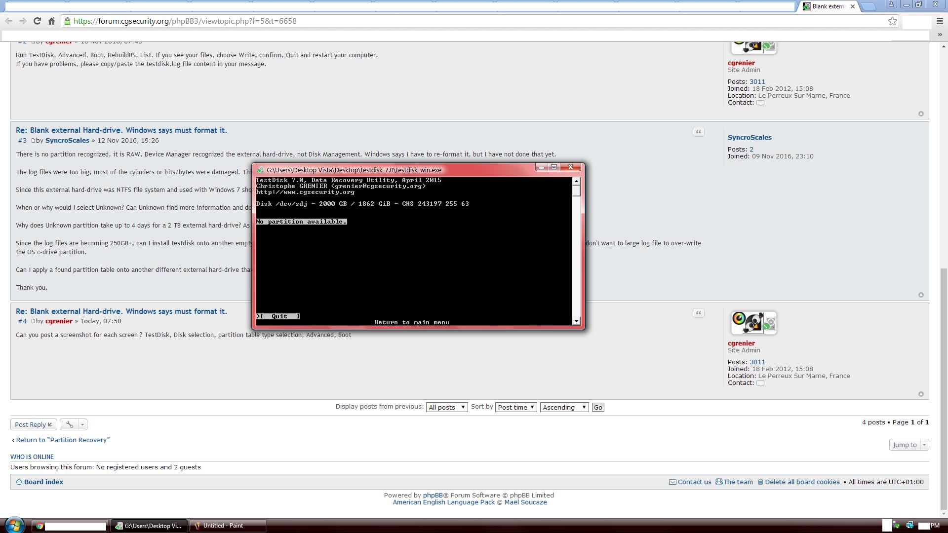

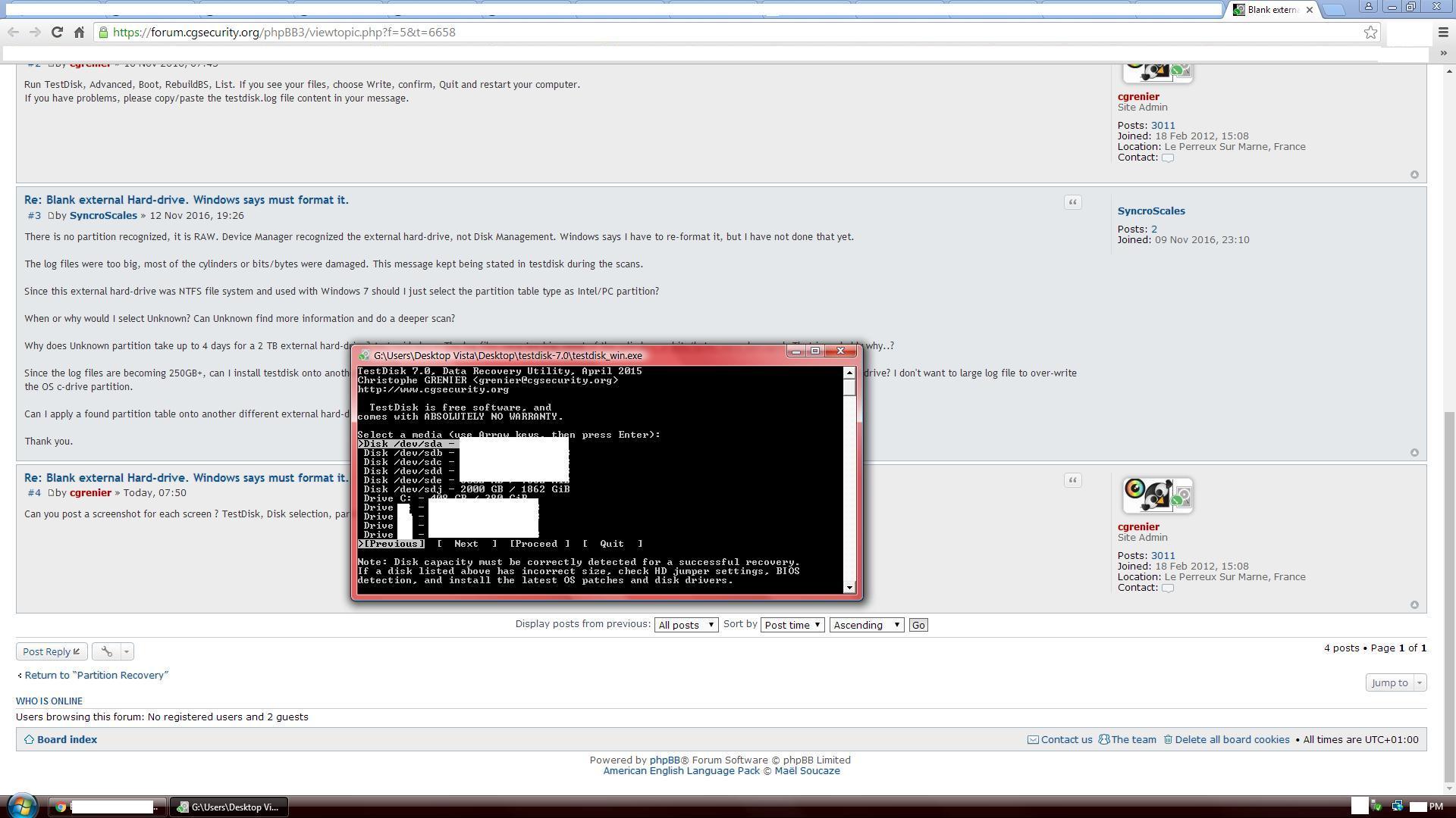

Hello cgrenier.
I attached 5 screenshots.
Testdisk 1-4 JPG's are when I select Intel/PC partition.
Testdisk 5 JPG is when I select None non partitioned media.
At the second screen (Disk selection) to detect all the blank media and HDD's, I blocked out everything else except Disk /dev/sdj (this is the external hard-drive).
Another question I have is: At the second screen (Disk selection) I also noticed some drive letters are not recognized. I have 4 internal drives. Drive E does not show up in the drive letter area at the bottom. But it's size shows up at the Disk /dev/sdb or c area. Is this normal? It is SATA 3, the other HDD's are SATA 2.
I am using Windows Vista Home Premium 32-bit.

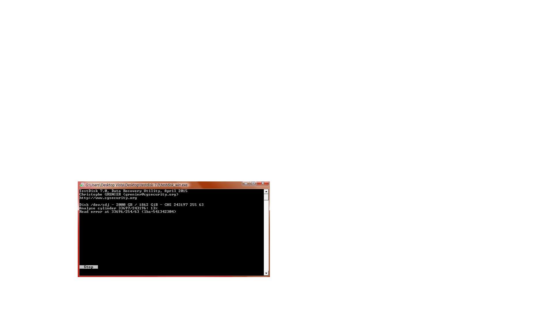

Screen Shot 4 and 5.
- Testdisk4.jpg (204.84 KiB) Viewed 11845 times
- Testdisk5.jpg (206.88 KiB) Viewed 11845 times

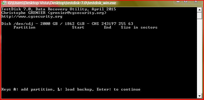

Hello.

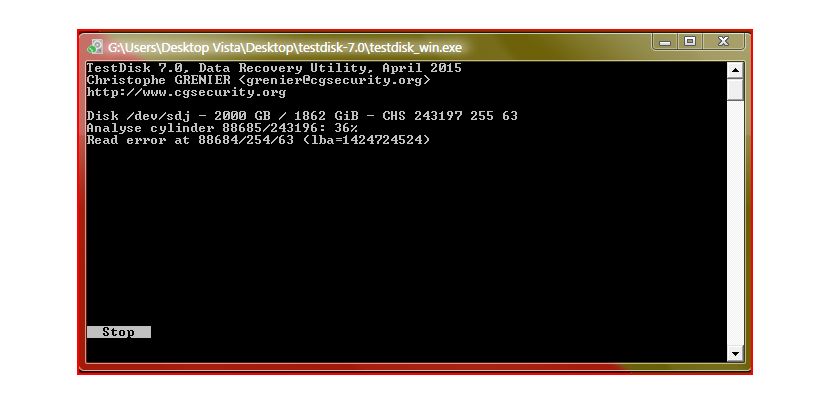

I ran the Unknown search and it took about 4 days. I did not do a deeper scan since I have to turn my computer off. Is it recommended that I redo the long scan and then a deeper scan?
I attached some screen shots. They are in order look at them from the first one down to the last.
Is it recommended that I try to image this unknown/corrupted partition onto another external hard-drive? I have one that is the same 2 TB size and empty.
I re-tried to use testdisk. I selected Intel/PC partition. The scan was much faster. I kept the log file. It is 1.59 GB. I then did a deeper search. The log file became 3.76 GB.
Nothing shows up.
Any advice?
Nothing shows up.
Any advice?

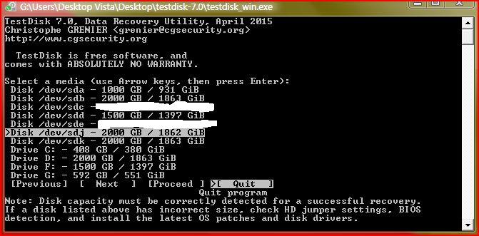

When looking at the Testdisk menu I plugged in soem external hard-drives and media. I noticed that the corrupted Western Digital hard-drive is a smaller size than other external hard-drives. Some are Western Digital.
Look at Disk /dev sdj - 2000 GB / 1862 GiB - This is corrupted and not showing partitions. Western Digital My Book 2 TB.
Look at Disk /dev/sdk - 2000 GB / 1863 GiB -This is a Western Digital 3.5" 2 TB HDD in an enclosure.
Look above at Disk /dev sdb - 2000 GB / 1863 GiB - This is an internal Western Digital 3.5" 2 TB HDD. Drive D.
Please ignore these drives: There are some flash sticks and other external HDD's I plugged in to see what is happening with them. Drive C is partitioned into drive C and drive G.
The log files are large in GB's. I am having trouble opening them, so there isn't mush information I can post at this time. How can I post them up?
Thank you.
