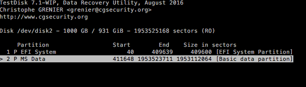

Ok so I tried doing the superblock method but the problem is I can only see two partitions,
Screen Shot 2016-11-23 at 22.15.50.png (28.33 KiB) Viewed 7854 times

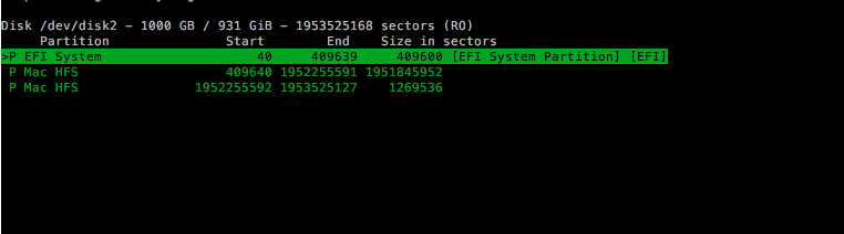

and if I do superblock to the MS data (type changed to hfs+) it says that volume header is bad. Also I think that I should not do it to this partition, since quick search with the [analyze] shows a third partition, which is much larger and probably has all thats left of my files
Screen Shot 2016-11-23 at 22.18.47.png (21.03 KiB) Viewed 7854 times
In this screen I chose [write] and rebooted.
Now I can see the volume that I had before format but only in disk utility. The volume has the original name but it isn't mountable.
I tried doing super block to this new partition and it says the volume header is ok and also the backup is ok but that they mismatch.
So i tried overwriting the header with the backup, but it says write error. I am now stuck

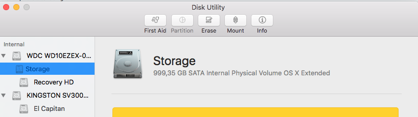

Screen Shot 2016-11-24 at 20.02.49.png (51.9 KiB) Viewed 7828 times
It now looks like this. Before disk utility could not see any volumes but writing the partition table made those two appear. Only problem is I cannot mount the "Storage" (the volume that has my files) and fsck says it is read-only, so I cannot repair the filesystem. I cannot figure out how to make it writable, since all the methods I've found require you to mount the volume first.
