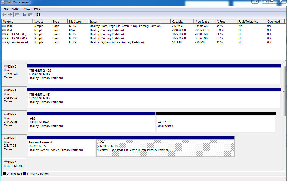

I used the left/right arrow key to change it to P(rimary), hit enter and chose Write, then confirmed and quit. It prompted me I would have to reboot for the changes, which I did.
I am seeing the drive in 'My computer' as drive G: in the list, but it's not accessible. Looking in disk management, I'm seeing a second partition on drive G: there that states 'Unallocated'
Looking at TestDisk, I'm seeing the new drive letter and partition that was created, as well as another entry for the drive that is likely the other unallocated part:
If I arrow down to drive G and select it in TestDisk I am seeing it defaults to 'None':
Given this scenario above, I am wondering what is recommended from here? I appreciate any help, thanks.

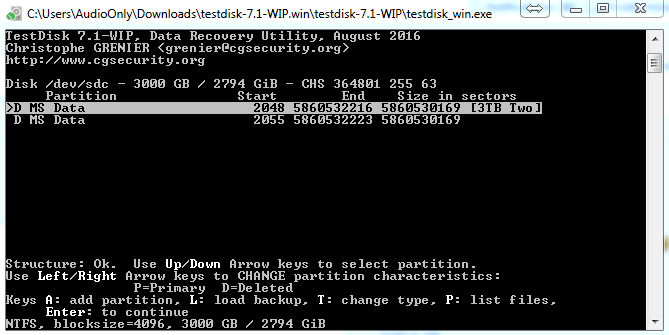

Since the last option was Continue and didn't seem to be anything that would change or write anything I hit enter, and I'm seeing the two parts of the drive here:
The first entry contains my files when I press 'p' to list them, and shows the 3TB Two at the end. The second entry states 'Can't open filesystem. Filesystem seems damaged.' when I press 'p' on it.
I'm seeing they are both showing as as type 'D', although I changed the first entry to P(rimary) from the previous part of this. Wondering what I should do with these two entries.
Re: Found my deleted partition, do I use A for Add? Or go in and copy all?
#9 Post by cgrenier »
Set the first entry to P(rimary). On next screen, choose Write, confirm, Quit and restart your computer.
