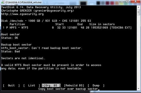

At times, trying to access the harddisk, I will encounter folder or file inaccessible due to "access denied", "location not found" and latest is "function incorrect" after going through Testdisk with the below system fault.
Tried Advance as nothing can be done through Analyse.
Rebuild BS.jpg (57.14 KiB) Viewed 4198 times

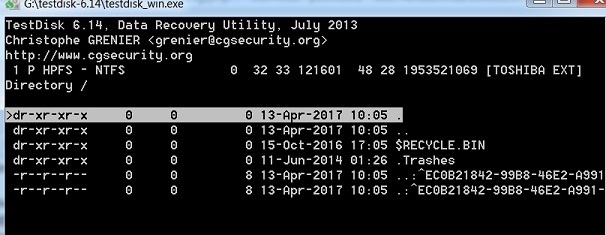

The List didn't show all the folders, all the folders are missing.

If TestDisk doesn't list your files, check the Recycle.Bin and .Trashes directories.

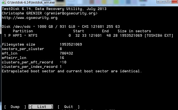

For the first solution, Use TestDisk Advanced, List
Only if it failed, use PhotoRec.
