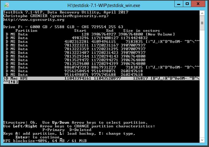

Hello I'm running Windows Server 2012 and had a 3 HDD RAID 5 running with 2 Seagate and 1 Hitachi, each 2TB (at least I think is was RAID array, might've been JBOD). Long story short, the server reported a disk error on another RAID array I had in the system. But could not locate the HDD with the error. Looking deeper, the card the was mis-reading the disks. So the card was going or had gone south. 3 cards later, I 9with help from much smarter folks) discovered the MotherBoard had given up as well. I scrambled to get the data off the larger failed array and was using this smaller storage to hold data in the meantime. When I replaced the Motherboard and array card, the durn thing did not recognize the smaller storage pool and formatted it before I realized I had data on the drive. I've gone through several renditions of rebuilding the array and running TestDisk (current version Apr 2017) and could never get much to show up. I've finally got something, but am not sure what.
TestDisk Results 2.JPG (87.46 KiB) Viewed 4604 times

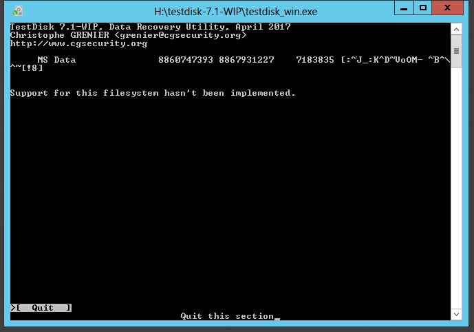

And each Line item shows
TestDisk Results 3.JPG (40.84 KiB) Viewed 4604 times

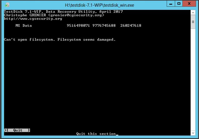

Except for the ones with the funky long names, they show
TestDisk Results 4.JPG (42.37 KiB) Viewed 4604 times
What is MS Data? And since this should be 3 2TB disks, what am I looking at? What should my next command be?

You searches for partitions inside a partition (F:). It's totally useless.
Without the testdisk.log file content, it's harder to understand the situation.
It looks like you have a 6TB F: filesystem, probably inside a Raid 0 with 3 disks of 6TB (3*2TB) and not a Raid 5 of 3 disks of 2 TB ((3-1)*2=4 TB).
