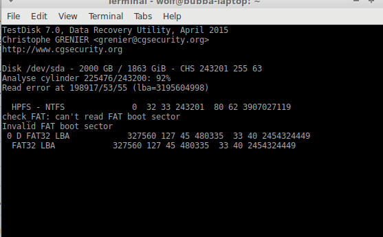

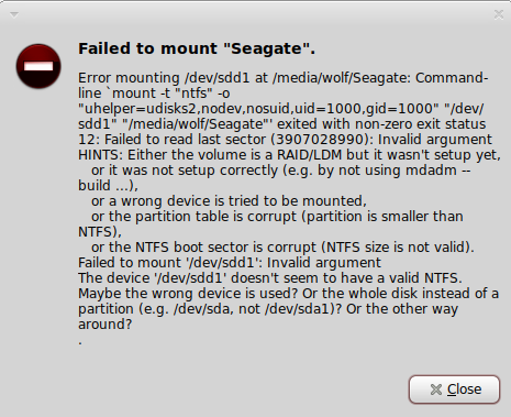

I had a drive that was starting to get bad sectors so I ran a deep scan using test disk. Prior to this it would still mount and i was readable. Now I can't access it at all. I dont have a windows computer just a linux one, what the hell happened? Also the last tie i did this it redid hte mfy in terminal but this time i dont know how to make it othat, it said i would have to reboot r changes to be permanent but i i don't know if it was talking about hte os or the disk itself.
I've attached my log.
testdisk error.png (32.46 KiB) Viewed 1891 times
ntfs error.png (39.82 KiB) Viewed 1891 times
