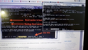

Last week, after I took some picture with my phone, it was found that some, not all, photos were corrupted. I closed all apps, removed and re-inserted the microSD into my phone. Alas, my phone doesnt detect it anymore, nor does the desktop. After several attempts over several days, my deskptop finally detects it but prompts for format disk. At least, theres hope now.

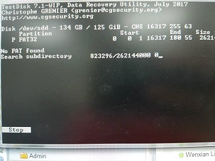

However, when I ran testdisk, first issue was Unknown partition. After that, when i manually selected the type it says NO FAT FOUND.

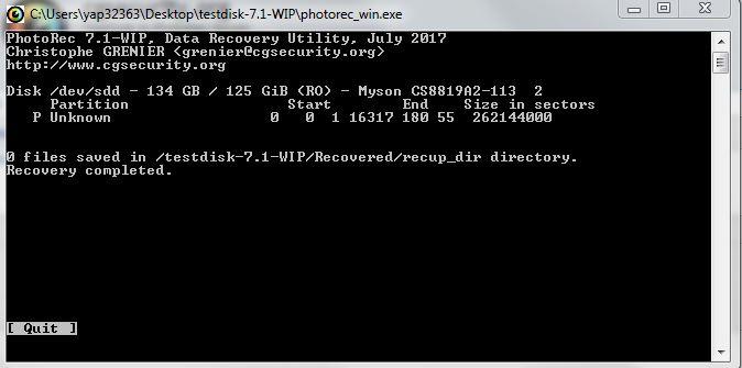

I then ran Photorec in the hopes of recovering something. scanning took a little over 10mins with 0 files found.

- testdisk - cant read boot sector.jpg (28.99 KiB) Viewed 1954 times
- Testdisk - No Fat Found.jpg (25.97 KiB) Viewed 1954 times
- Photorec.JPG (41.29 KiB) Viewed 1954 times

When trying PhotoRec, choose [Whole] instead of [Free].
Do you get better results ?
Do you read error messages while PhotoRec was running ?
