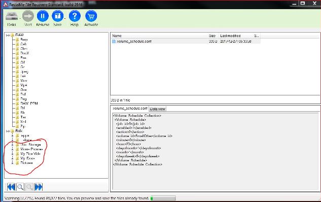

So I have a drive that was in my ReadyNAS I had used as a backup before reformatting. This drive was NOT part of the 4 disk RAID, but was an additional volume. Thought I would be able to recover the data once I reformatted the 4x disks of the RAID if this was separate during said format.
After the format I put this 500GB drive back into the ReadyNAS and (THOUGHT :x ) I was recreating the link to the current data, but ended up deleting the partition table...
There are about 15,000 pictures in about 1,000 different folders. Below, the first picture shows the folder structure --inside the red circle--of the "BTRFS" that I would like to recover but NEED HELP to ensure I do not lose all the photos of my family and more. :(
Second pic shows the hex data if that helps anyone.
Third pic is the scan from TestDisk I hope to rescue my pics and docs.
Any advice offered (Linux dumb here, but have an Ubuntu VM on hand) would be great (please speak slowly, and clearly) help and appreciated!
SGT Oldy
Re: Help recovering from single RAID volume
The screenshot shows that another data recovery utility has been able to list your files, so why not use it ?
You can always use photorec to recover your pictures but it will not recover the original file structure.
#6 Post by cgrenier »
The pictures you post previously are not available anymore.
I don't think it's possible to convert an btrfs filesystem to an NTFS, the best method is probably to backup all the files, reformat the partition and restore the files. For that you need to have access to the files in the first place...
