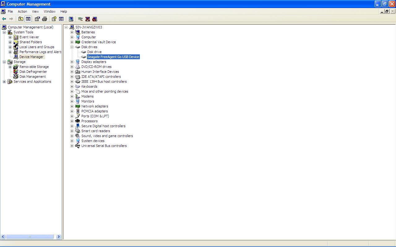

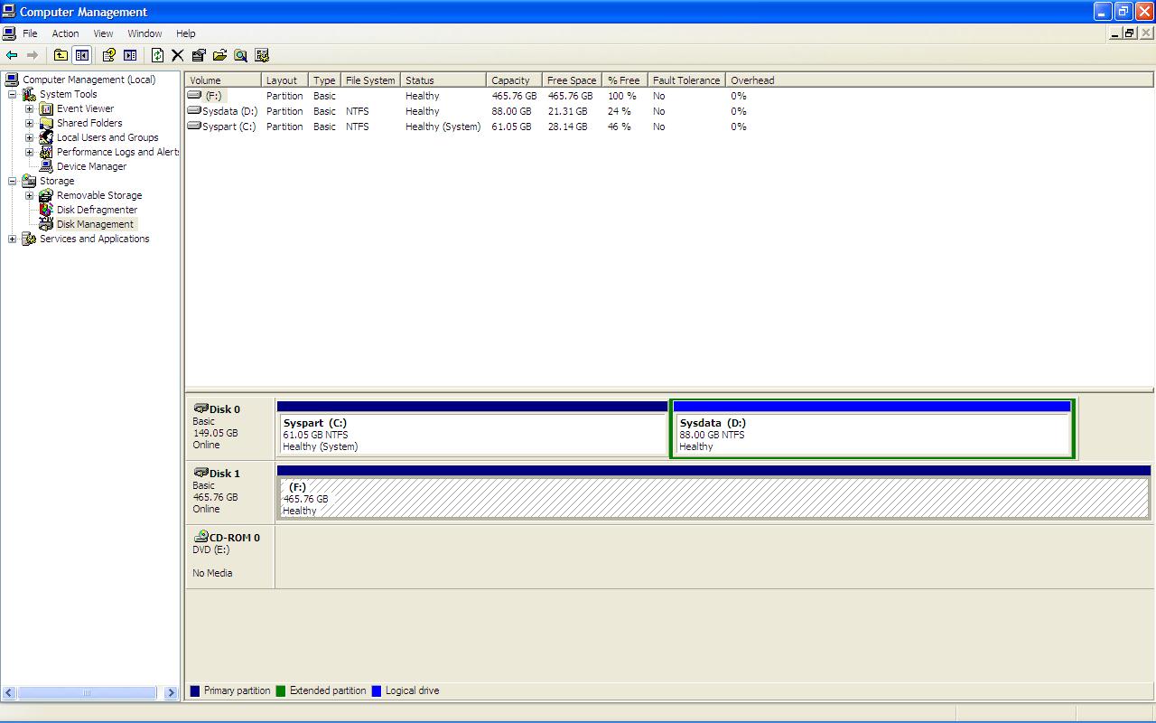

Looks like your LBA (Logical Block Addressing) from your disk is bad?
TestDisk doesn't change anything to your disk.
When you tried to copy data and testdisk doesn't respond or hang will indicate that your file system is damanged or doesn't get recognized..
The first steps are;
Got to your device manager.
Check how your disk is listed.
Compare name, model.
Second step is check your disk management console.
Please upload a screen shot.
Use CrystalDiskInfo to check your current disk status;
http://crystalmark.info/software/Crysta ... ex-e.html/
As far as possible don't stress your disk anymore and don't change anything where you're not 100 % sure.

In fact, I recovered ~10% data by using testdisk. it was really surprising testdisk quit in middle of copying, and then the partition and file directory are gone. :(
i followed your instructions and got two screenshots (device manager.jpg, disk managemetn.jpg) which show no issue on disk.
