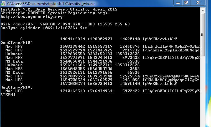

Some days ago – after windows update from 2019/03/13 – my PC no longer didn´t work properly. So I decided to make an acronis trueimage-recovery from an external device. Unfortunately I made a mistake and stopped the recovery after ca. 5 seconds, because I thought, that I selected the wrong/older image from list. Bad mistake.
This 5 seconds were enough to destroy the function of my SSD. Computer isn´t bootable because of missing OS. I tried to repair it with the acronis rescue media but it didn´t work. An error message appears that acronis isn´t able to make the device bootable.

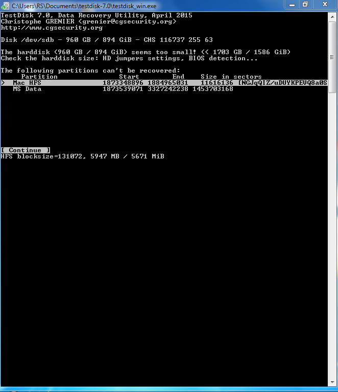

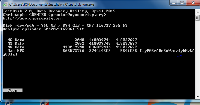

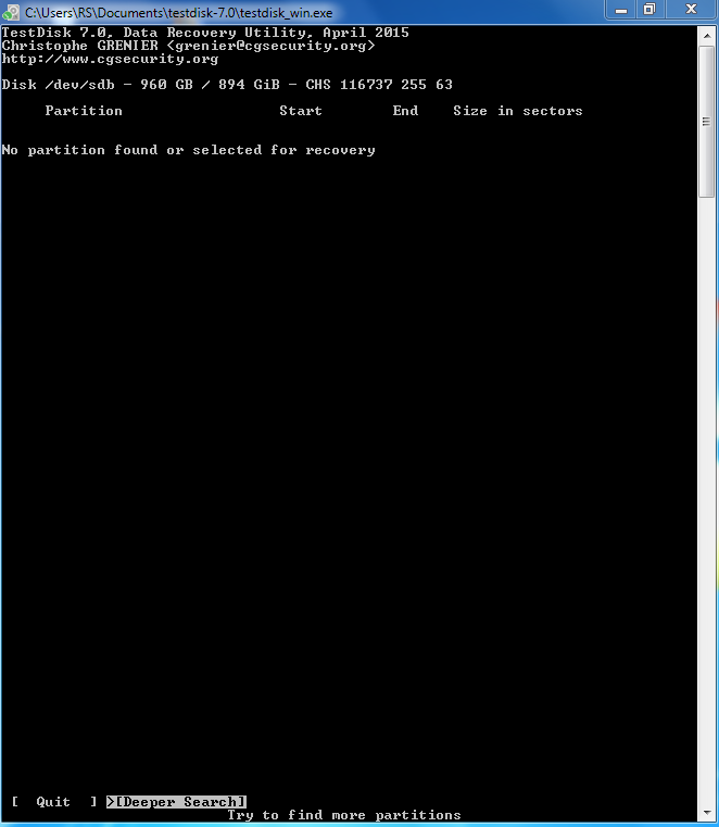

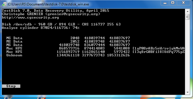

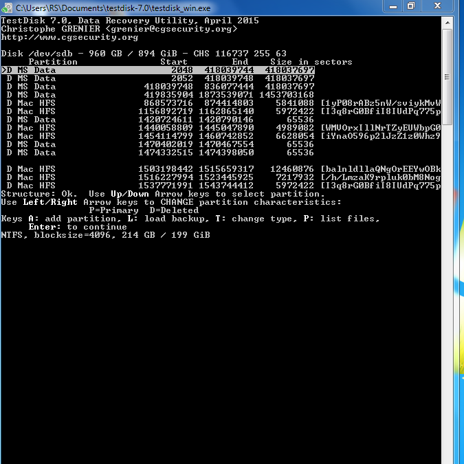

Using testdisk I got these results - please notice attached screenshots (chronological)
What means mac HFS? There was no contact with apple/mac. And no...-the disk isn´t too small. :?
For me the problem isn´t a matter of data recovery so I had two acronis images on external drives. I hope that it is possible to make the disk healthy again, so that acronis will accept it. I´really would like to avoid installing windows again.
Thank you in advance for help and advice!
Testdisk log stated below as attachement.

If you had a backup from before the problem, why can't you restore it ?
Even if you stopped the recovery after 5s, you should be able to restart it again from the beginning.
I use an older version of Acronis TrueImage as well.
There are two possible explanations:
Either Acronis gets confused by the broken partition info or Acronis fails to write to your SSD.
To exclude the second case you should check the health status of the SSD.
With regards to your existing backup you might try to completely erase the SSD in question.
