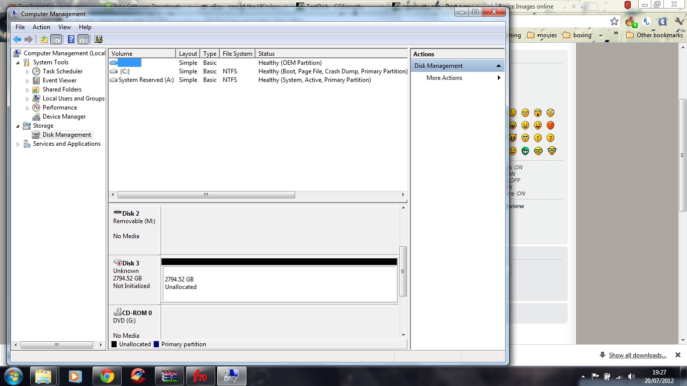

Would it be possible to upload a screen shot from, your disk management console and from TestDisk Analyse also?

Yes I will upload a screen shot from disk management. Analaysing the hard drive takes a long time, im using a sata power adaptor to USB 2.0 should I just connect it in my pc, would this speed up the analysing process?

by abzkahn

Currently ther is no partition in your partition table.
It's not initialized and empty.
Since W2k a disk must be initialized, that TestDisk can handle it.
Did you use it before externally?
Is there a description on your disk about advanced format drive?
Is important to determine, to set it up as Intel or GPT-Disk.
Was your disk before internally and a GPT disk?
