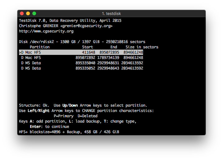

Can you please help me recovering my backup HDD? I don't know how to proceed.
It's a WD Elements 1.5TB, one 1TB exFAT partition that successfully gets mounted and a 0.5TB that doesn't get mounted.
This is what I get when running fsck_hfs /dev/disk2s1:
Executing fsck_hfs (version hfs-366.70.3).
** Checking Journaled HFS Plus volume.
Invalid B-tree node size
(3, 0)
** The volume could not be verified completely.
This is the result of a deep search:
deep search.png (81.48 KiB) Viewed 19041 times
I see two repeated partitions. I think I'm supposed to mark one of them as primary and let the other be deleted, but I don't know which one to choose since I can't see files in HFS partitions.
What should I do?
Thank you!

The first partition labeled "Mac HFS" should be the right one because the second partition labeled "Mac HFS" overlaps with your partition that is 1TB big.

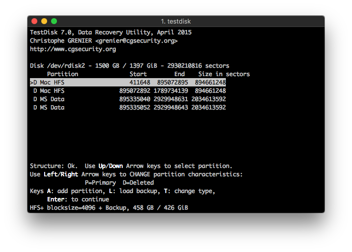

One thing I've noticed is that each program/disk mode I run has a different idea of where the Mac partition ends (or starts!). Please take a look at this screenshot: https://ibb.co/99sLMhh
The top one is PhotoRec, the middle one is TestDisk when I select Intel before searching and the botton one is Testdisk when I select EFI GPT before a deep search (my computer was turned off in the middle of a deep search, and after that it started displaying those weird results). The all have different End values and PhotoRec also has a different Start value.

Picture 2 could be the status quo, Picture 3 is the result of the pending analysis.
Picture 1 could be maybe the result of writing an old school Intel style partition table on a disk that already contained a GPT.
