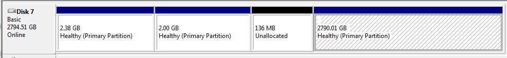

I pulled the drive from a Synology NAS to try and recover files from it (from the "2790.01GB Healthy (Primary Partition)" ).
I've tried it on both Win7 32bit and 64 bit, and both give me the same problem.
Windows Partition manager correctly shows the size of the drive at 3TB:

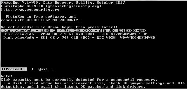

However PhotoRec does not, and instead shows 801 GB as the drive size (it does correctly identify my native Windows drives as 1TB and 2TB respectively though):

Do you have an incorrect disk size when using the 7.0 version ?
Can you also try the linux version of TestDisk ? See https://www.cgsecurity.org/testdisk.pdf on how to create a Linux LiveUSB.
