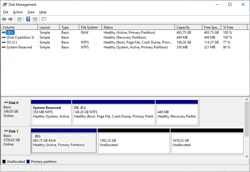

Windows Disk Management reports the disk as RAW with 3 partitions. 465GB Primary partition, 1582GB unallocated, 1678 unallocated. These partitions are new since disk to disk copy. See attachment.
Disk Management.png (31.81 KiB) Viewed 16178 times
I really don't know what I'm doing or how to move forward. Tempted to start the drutility but since it took 16 days on disk to disk copy I'd like to see if there is anything I can first.
Thanks in advance.

AndyT wrote: 16 Apr 2020, 18:40 I started Windows 10 instead as I was curious to see if the clone had worked at all, but I cannot access the drive, I'm being asked to format the drive.
Once Windows 10 starts writing on your copy your copy is not a copy anymore and you can duplicate another 16 days with the risk of degrading a drive which may be in the process of dying.
If you want to play around with something play with a duplicate of your duplicate.
As a bit more background with this issue, the failing hard drive is an external NTFS 4TB USB hard drive. It was originally connected to a Ubuntu server running Plex.
This is information you should have stated right at the beginning of your thread.
Since it failed I've setup Windows 10 instead and have added a new internal 4TB hard drive which was set as the clone destination. I obviously don't want to format the drive.
"Setting up Windows 10" is not necessary for the duplication process as described above.
AndyT wrote: 18 Apr 2020, 01:52 I tried rebuilding the boot sector, but this didn't work. It spent a while working through the disk looking for ... something ... but came back and reported the boot sector and backup boot sector as bad.
There is no need to rebuild anything as you already managed to copy files from your broken driven using Testdisk.
Using a logfile with ddrescue allows you to interrupt and continue your duplication process.
Do not connect your broken drive or its copy to a Windows machine anymore.
Try to rescue as much as you can. If file fragments are located in the missing 15% of the drive where you recovered 85% you won't recover those or getting shortened files or files that are impossible to open.
When being unhappy with the result of Testdisk you can run Photorec on your duplicate afterwards from a Linux system.
