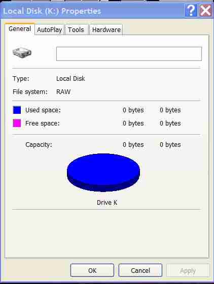

Please let me know, did you get your disk initialized?
NO "initialization" was not done to the disk...In my computer management on XP it is not as option when I right click it.
![CropperCapture[173].jpg](./download/file.php?id=571)
- CropperCapture[173].jpg (23.35 KiB) Viewed 14984 times

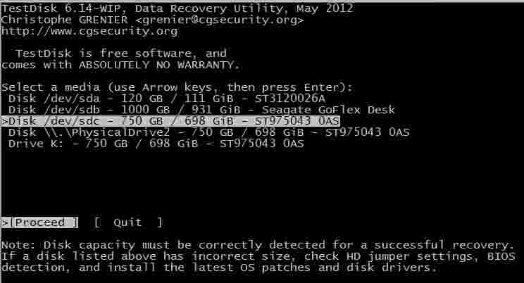

TestDisk displays your disk as drive.
It does show option as DISK in the beginning of the process...
- capture
- CropperCapture[8].jpg (18.25 KiB) Viewed 14984 times

Fiona wrote:Please have a try to select your disk instead of a drive.
I chose DISK, "analyze" and this is my this is a description of my "current partition structure" with TestDisk.
![CropperCapture[3].jpg](./download/file.php?id=579)
- CropperCapture[3].jpg (21.63 KiB) Viewed 14979 times
