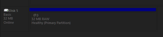

so i recently installed a new graphics card in my system and after i booted up one of my drives shows up as 32mb raw. when i was installing the graphics card i had to remove a couple of drives because of tight spacing in my case, so maybe i touched the case with the drive?? i didnt drop it or anything like that and all the others drives are ok, its just this one. its a Samsung HD103UJ 1TB SATA drive on a Gigabyte 965P-DS4 and im using windows 7 64Bit pro.
this is was disk management says:

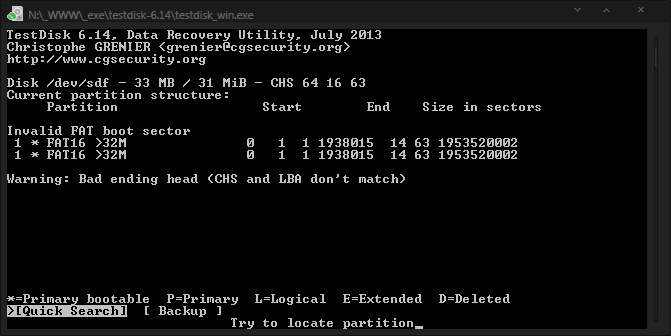

and this is what testdisk says:

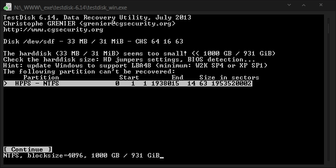

and after quick search
from what ive read so far, the 32mb must be the file cache thats being recognized as a partition. ive also read that the 32mb problem happens disproportionately often on gigabyte motherboards.. ive also read that it could be a firmware problem with the hard drive. meaning, something in the hard drive firmware must be rewritten..(?)

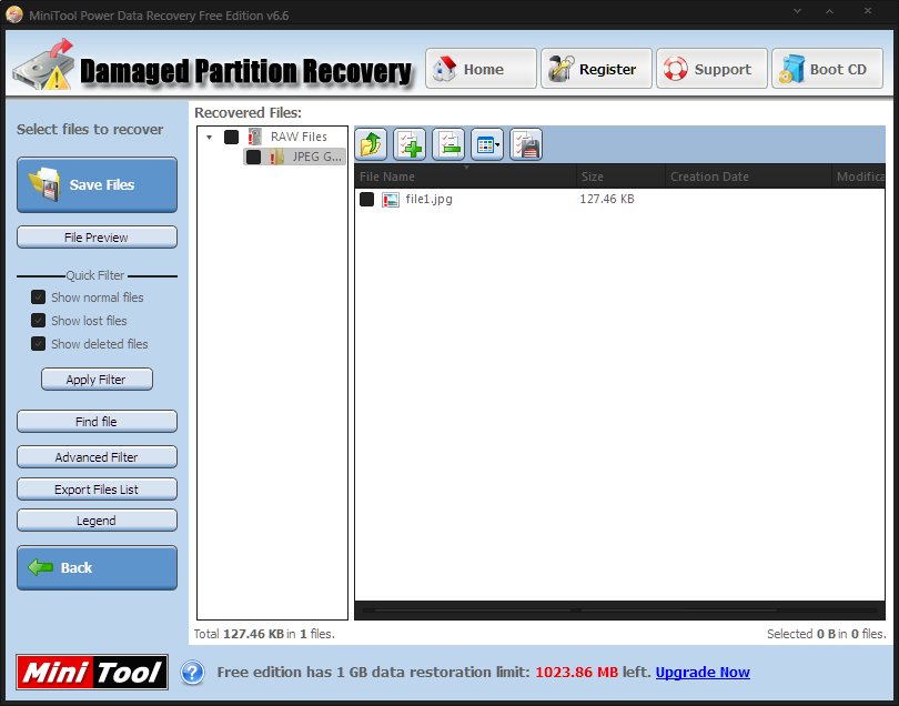

also, i forgot to mention but i tried a tool called MiniTool Power Data Recovery and this is what it looked like:
i was able to actually recover this file and it was fine. i dont know if its from the cache though??

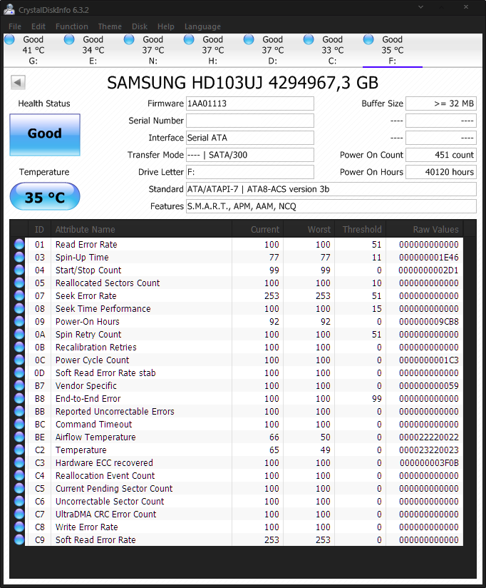

and heres what crystal disk had to say about the drive:

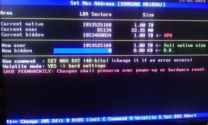

so when i use HDAT2 i go into the "SET MAX" menu and enter the "NATIVE MAX ADDRESS", right? and if there is a hidden address (most likely the HPA) i remove it?
Yes, exactly.

after failing to boot into hdat2 with the cd-image for some reason, i used a usb key with win98 boot files and hdat2 on it. i disconnected every other drive except the broken one, booted into dos and loaded hdat2. right on the first screen it tells you that it detected an hpa on the drive. in thr 'set max address' menu i set the new max address to the native size and hidden area size to 0. i left the lba address mode at 48-bits. after i saved these values i rebooted into windows and my drive was exactly as i left it. windows recognized it like before (even the drive name was the same) and all files were there.
so yeah, lesson learned, gonna back up my files from now. thanks to fiona for helping me!
and heres a pic of hdat2 in the set max address menu, right before saving
