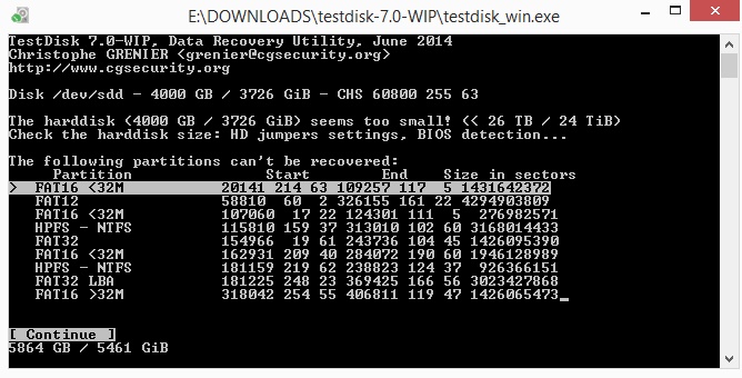

I have 4tb seagate backup plus
while aligment electric loss and my whole partition went aswell
now I try to save back but got some problems here what I get after scan
but I dont know which is my partition
I had first day fat32 formated full ps3 game hdd which nmust be 4tb
but all result is wrong system or shows bigger than normal 16tb-8gb... etc
please help
Seagate Backupplus 4tb LOST PARTITION while aligment
- 4tbEkran Alıntısı.JPG (53.56 KiB) Viewed 5705 times
Re: Seagate Backupplus 4tb LOST PARTITION while aligment
Your screen only displays unrecoverable partition.
If you confirm with enter, you'll get to the results.
I'd need a screenshot from Analyse and Deeper Search.
You can stop Quick Search to save time.
The results are important.
Did you use testdisk 64bit?
In case you should use the 32bit-version instead and select Disk instead of physically drive.
A 4 TB disk scan can take time.
If you think your right partition is found and displayed (for example has its label), you can press enter to stop the scan.
Mark that partition and press p to have a try to list your files.
What kind of partition table type uses testdisk?
Intel or EFI GPT.
TestDisk finds it automatically.
Your partition type is FAT32 LBA.
here is Deeper Search results
I get 3 partition all invalid
I choose fat32 lba one
but says cant be recovered
and
Im getting 'no partition found or selected recovery' msg
then I get partition read error all other actions
my hdd was MBR base 4tb primary fat32 partition(not gbt...its speacialty for seagate backupplus )
I was using Paragon Alignment Tool 4.0 Professional for aligment ,inthe middle power-loss
Would it be possible to use the 32bit version?
I did with 32bit version same results
here is the log file:

Disk /dev/sdd - 4000 GB / 3726 GiB - CHS 60800 255 63
The harddisk (4000 GB / 3726 GiB) seems too small! (< 26 TB / 24 TiB)
FAT16 <32M 20141 214 63 109257 117 5 1431642372
FAT12 58810 60 2 326155 161 22 4294903809
FAT16 <32M 107060 17 22 124301 111 5 276982571
HPFS - NTFS 115810 159 37 313010 102 60 3168014433
FAT32 154966 19 61 243736 104 45 1426095390
FAT16 <32M 162931 209 40 284072 190 60 1946128989
HPFS - NTFS 181159 219 62 238823 124 37 926366151
FAT32 LBA 181225 248 23 369425 166 56 3023427868
FAT16 >32M 318042 254 55 406811 119 47 1426065473
Does paragon supports "advanced format" ?
Intel MBR only supports partitions up to 2.2 TB.
Why did you try to align a partition?
Was your disk before working?
As far as I've seen, Deeper Search didn't find your previous partition either.
Until yet, testdisk didn't find any fat32 lba-partition, which would fit to your disk.
Would you be able to create a fat32-partition which would fit exactly like your previous partition?
But don't format it.
Otherwise you'd override your underlying partition.
In this case, you'd be able to diagnose a boot sector and maybe to recover your partition?
If you create an unformatted partition, it would be only written to your partition table in your MBR.
So it doesn't touch any data within your partition which starts by a boot sector.
Otherwise you'd need datarecovery software.
Please let me know.
Please let me know.
