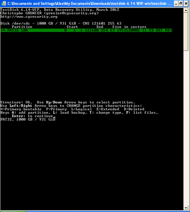

My external hard disk got into problem about 9 months ago. I have been spending a few hundreds hours trying to find a correct answer to fix the problem.
I was about to give up when I come across your website by Google. It seems to give me the last hope.....
I download and ran TestDisk. The following is the scanned result:
I followed the instruction to write the partition and restarted the computer. However the situation is still the same.
P.S. I also tried to recover the data by a software before but fail. The reason is "mismatch FAT".
Anybody can help me to fix the problem. The hard disk has some very important files.
Best regards
Alex

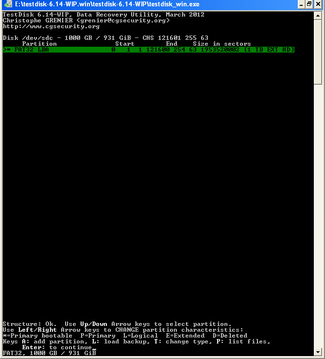

Re: Buffalo 1T External Drive - The drive is not formatted..
It took me the whole day to do the Deeper Search. Here's the result:
It seems that there is only one partition.
Please advise what may be the problem of my external disk.

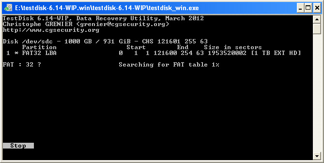

Thanks for your kind assistance!
I tried Advanced / Boot / and Rebuild BS twice. It always freeze at 1% after running for 2 or 3 hours. Please see attachment.
Best regards
Alex
Best regards
Alex
- testdisk-rebuild-bs.jpg (51.03 KiB) Viewed 9024 times
I also attached this screen shot. Maybe it helps to diagnosis the problem.
