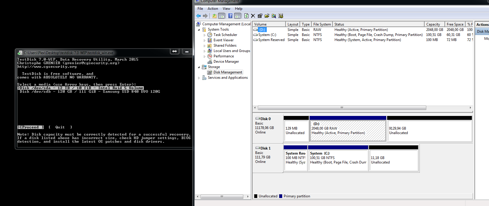

Overwritten partition table
- 900x900px-LL-8427aaee_Capture.PNG (38.23 KiB) Viewed 3630 times

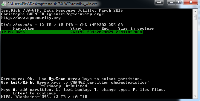

Should I delete from Windows the RAW partition first? As a side note: this storage was only used as Storage so I guess the Start sector should be a very low number, correct ? This is after the quick search.
When I go to list files/folders, I only get a few folders and pretty much nothing inside of them.
Under deeper search, I get the initial screenshot I posted in the first post.
