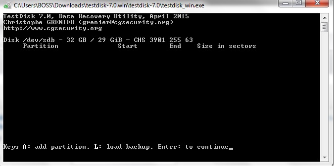

#7 Post by kapon »
Fiona,
Unfortunately I cant see any partition in my disk.
Here are the screen shots from the processes al the way to the result of "Deeper Search":
Initial Test Disk Screen
Initial Screen testdisk.jpg (70.4 KiB) Viewed 9252 times

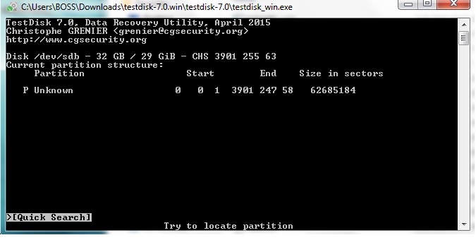

Before Analyze
Before Analyze
Before Analyze.jpg (68.84 KiB) Viewed 9252 times
Analyze Result
Analyze Result
Analyze Result.jpg (53.65 KiB) Viewed 9252 times

#8 Post by kapon »
Here is the Deeper Search Result:
After Deeper Search.jpg (44.83 KiB) Viewed 9252 times
So testdisk cant find partition. What should I do next to access and recover files in my microSD card?
