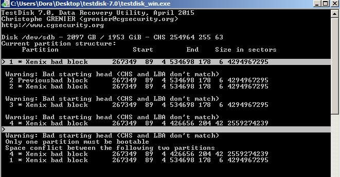

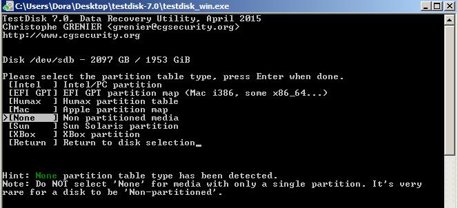

i need urgent help here, i have a usb sony vaio 2.0, 2TB exfat, and i don´t know why, it´s been a headache to solve this, because all information regarding that kind of error, the CHS and LBA conflict, or is a mess to understand, or is incomplete, and i need someone that can tell me step by step please, how can i solve this problem to get my stick back
i have "None" partition table type has been detected
click on "Intel" option
"analyse"
and get the
Warning: Bad starting head (CHS and LBA don't match)
4* Xenix Bad Block
1* Xenix bad block
I will be very grateful if you can help me with this
thank you in advance
Help-Warning: Bad starting sector (CHS and LBA don't match)

Can you repeat your diagnose running partition table type Intel instead of None.

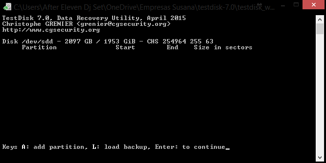

Now, i have made another analysis, and the result of this one, was different from that first photo (see photo attached).
Made another one and now i have only 2 options, and one of them is (create partition pressing in "A"), but i don´t know what to choose from here, because it asks me for the "Geometry, Head, Type, Sectors", and i don´t know nothing about this, i read all the articles related to this, but none has been conclusive, or none says me what to put under this configuration.

Here are some screen shots of what happens after analyse
When i click create partition, appears some things that i don´t understand like "geometry", "Head", "Type", "Sectors", and here is where i get stuck, because i don´t know the wright values to input, and i can´t pass from this menu.

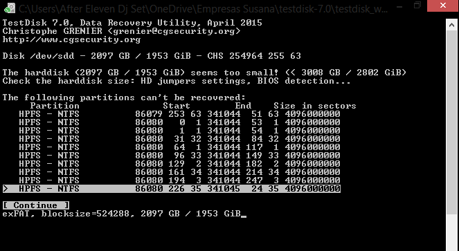

Hello my friendFiona wrote:Can you repeat your diagnose running partition table type Intel instead of None.
You'll find it within your testdisk folder and you can open it using wordpad.
well i´m trying to give you the log file, but i can´t pasted because it exceeds the character limit, i tryed to insert a "div", "code" or "list" but it doesn´t allow me, it´s always saying that i´m exceeding
so i put it here in this link testdisk.log
and now i´m in the same position and don´t know what to do (see Photo)
Thank you very much for your kindness attention to my case
- 2.png (9.78 KiB) Viewed 15132 times

Re: Help-Warning: Bad starting sector (CHS and LBA don't mat
Looks like you may have to use PhotoRec to recover your data. There are a lot of trace of exFAT partition but not of one using the whole disk.
