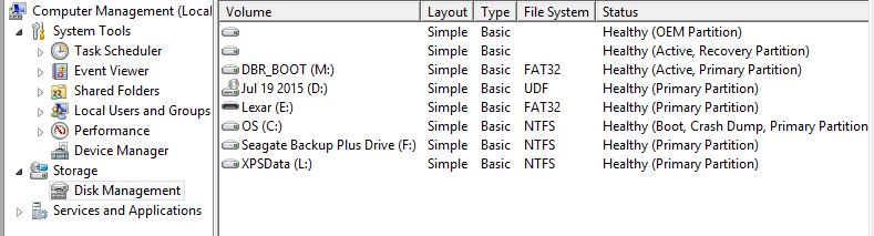

Disk Management does not see the corrupted external drive (please see Capture.jpg - attached).
- Captured using Windows Snipping tool
- Capture.JPG (50.13 KiB) Viewed 4954 times
Re: Restore files from a disk connected via USB 3.0
Did you already remove your disk out of its enclosure and test recognition in another enclosure and internally?
Is your disk listed in your device manager under disk drives correctly?
Did you already test another cable?
Does your BIOS/UEFI lists your disk correctly?
