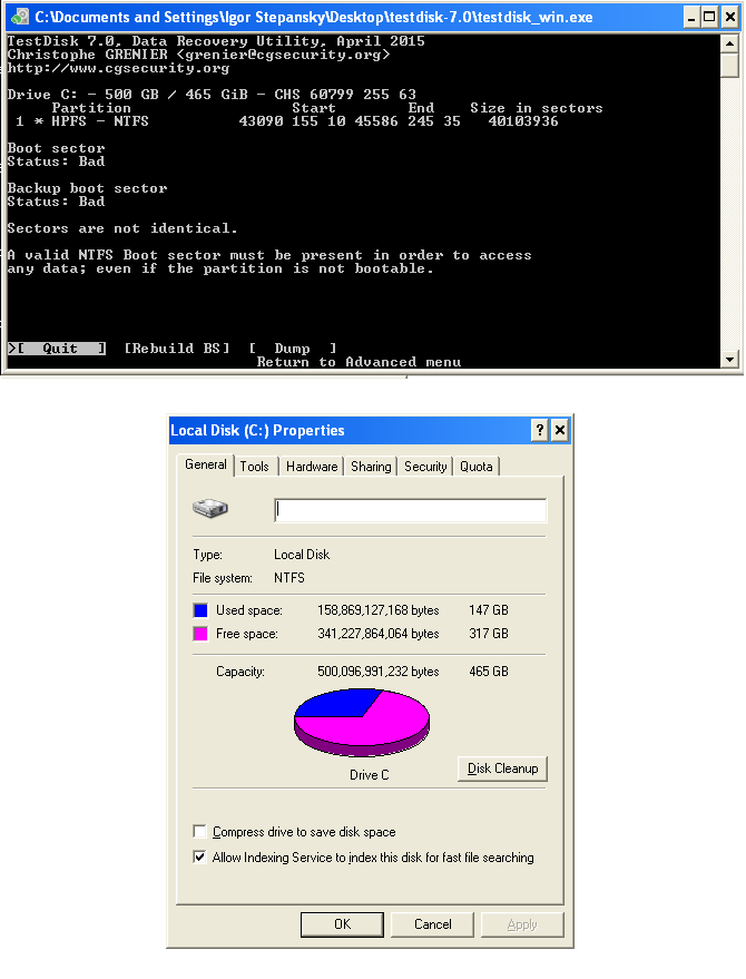

Hey I tried to Rebuild BS and it failed. Both my Backup boot sector and Bot sector have the status bad..
But the fact is i'm currently boot into both harddrive's as they both work fine I just did a stupid mistake by running the command fixmbr that comes with Windows Recovery Console and now I can't boot into the real windows mode only safe mode.
The Quick scan indicated I have a Linux Partition even though I know it's a NTFS, I let it set the Partition to Linux thinking that would fix but it didn't fix anything.. I have set it back to 07 which is HPFS - NTFS and I can't rebuild the Boot sector.
Here is a screenshot I'll be posting the log shortly

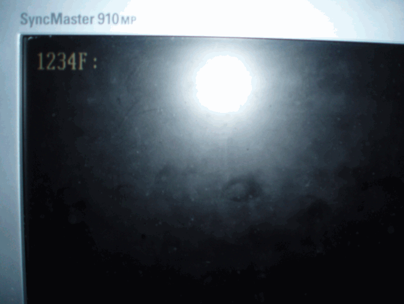

I converted it into the Linux which this tool testdisk recommended big mistake..

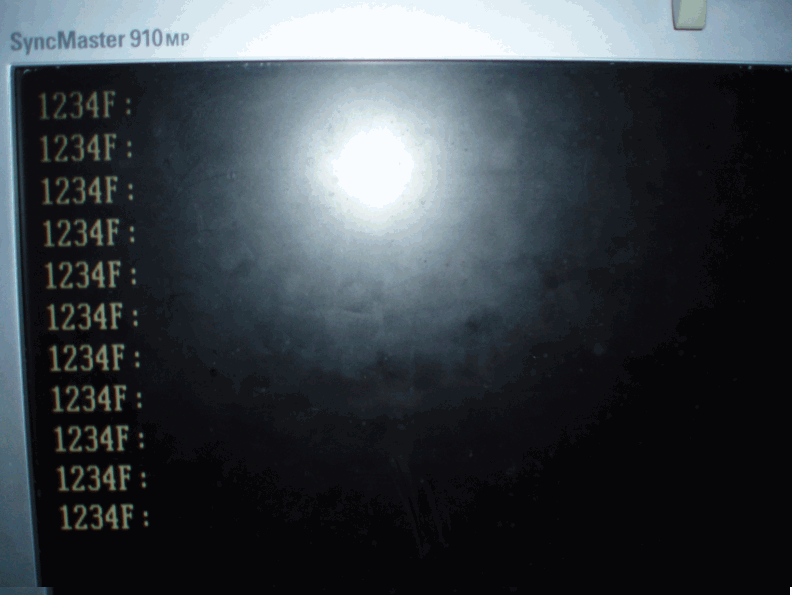

Now when I boot I get this error
If I press any key on the keyboard I get spammed with that 1234F messages

#4 Post by cgrenier »
If no partition is marked as boot, MBR code from TestDisk will display "1234F", so you can choose between the 4 partitions.
