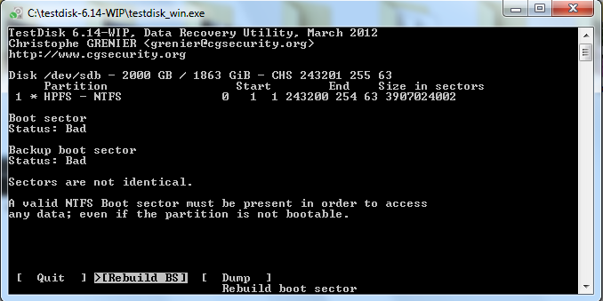

Basically, the 2tb samsung hard drive was a second internal data hard drive.
About 2 wks ago i uninstalled a freeware which forced a restart and since then i haven't been able to access the data hard drive . All i've been getting is error msg: 'the file or directory is corrupted or unreadable'. It has about 1.6TB data in it.
The HDD is bitlock encrypted but i have now set it to automatically unlock on my pc, and i have also removed it from inside the pc and it is now attached via a USB cable.
Here is the screenshot and the log file. Thanks.

I would suggest to have try to rebuild your boot sector.
Start TestDisk.
Confirm through until you see the menu Analyse.
Confirm at Boot with enter also.
Please, upload a screen to check your backup of the boot sector.
Infos will follow.

I've started the 'bs rebuild', which i'm guessing would take hours to complete, but i thought maybe you should see this screen.
Thanks.

Re: Please, I Need Help Recovering My 2TB Data Hard Drive
#6 Post by Fiona »
Your screen from your scan displays partitions beyond the disk limit.
That's why TestDisk displays the message that they are not recoverable.
TestDisk often finds partitions based on remnants or just recognize them this way.
Important would be the result of rebuild BS to find out does it find a path to your file system and data or not.
Please finish it and check it.
If it's not successful, please use PhotoRec to scan your disk.
Important is, does PhotoRec find your data?
If not, it could be a hint that your decryption after your crash was not successful?
Although decrytion worked and your partition appears as the partition type NTFS, but it's unformatted without boot sector and its backup (practically without a file system).
Thats why it's important to have a try to get data off of it.
Start TestDisk.
Please let me know, do you see your data or an error message
Hello Fiona,
I did as you suggested which, in itself, took about 40hrs to finish.
another thing, i was going to copy the log but the text file is showing 50GB in size. Is all this normal?
Anyway, attached is the screenshot, please advise.
Thanks again.
testdisk size.png (4.09 KiB) Viewed 12791 times
bs rebuild.png (87.17 KiB) Viewed 12791 times
#9 Post by Fiona »
It's not normal and looks like nothing was found.
You can delete your atachment testdisk.log, as it's to big to get somthing reasonable out of it.
Please have a try to scan your Disk for data.
You can use PhotoRec or a Trial of commercial software like Restorer Ultimate.
It's only important to see,do you see your data or not?
Some enclosure have a key chip integrated for encryption.
Especially WD My Book etc...
Then you woudn't find your data.
