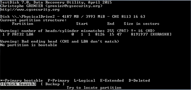

Hello, when I try to Analyze my flash drive (SanDisk 8GB) this is what it says:
After Quick Search this is the result:

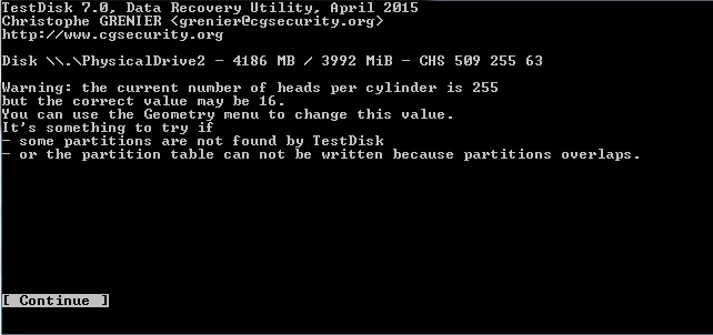

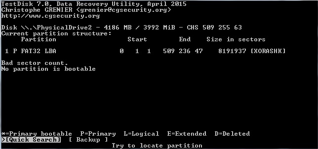

And then I tried to change the heads from the Geometry menu using the advised number of heads per cylinder and then I go back to Analyze again but it says:

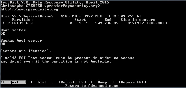

Here is the continuation, My bad, it's only 4GB :? . When I changed the geometry of the drive to the one that was adviced(by changing the heads to 16 instead of 255), I decided to go to Advanced menu and then Boot this is what is says:

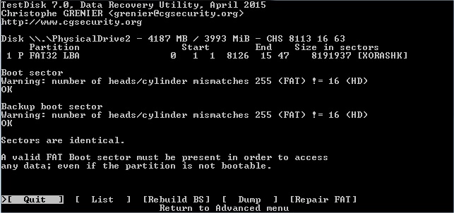

After that i decided to change the geometry back to the default one(by changing the heads to 255 instead to 16) and go again to Advanced menu and Boot but this is the result:
