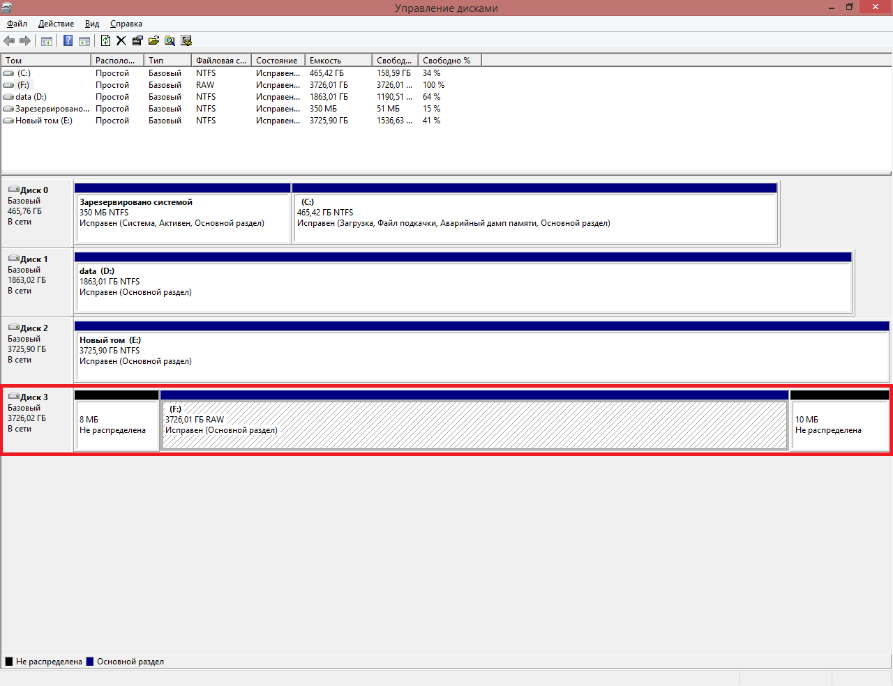

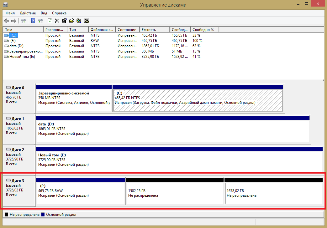

Hard drive had 1 partition only. Now I see 3 partitions: 465.75 GB (RAW filesystem), 1582.25 GB and 1678.02 GB

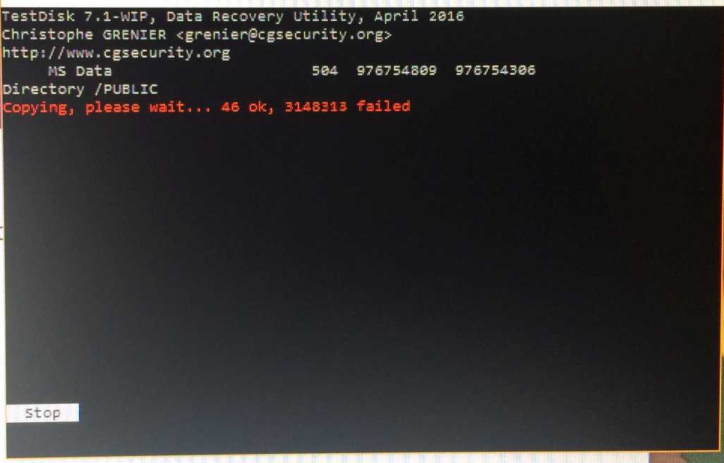

Quick search showed full directory structure, but repaired 2 files only (2 complete files and about 40 broken files)

cgrenier wrote:Is the size of F: correct ? If it's ok, run "cmd" (right click run as administrator) and "chkdsk /f f:"

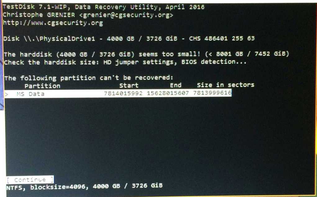

size of F: is not correct. It must be full disk.
Testdisk show this message "harddisk seems too small" after quick search (30hours)
a few days later after starting recovery files I still had two recovered files (about 7.7GB) only. And many failed files. Size of logfile was about 17 GB. First records from this large logfile is attached with first post

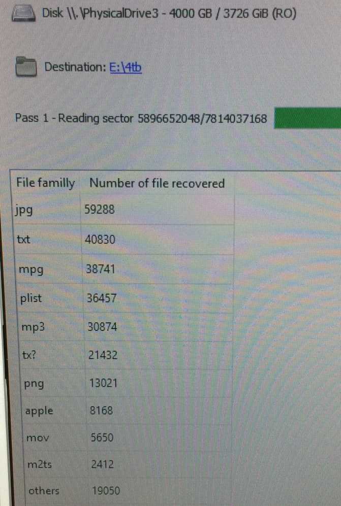

I try to recovery files via qphotorec_win.exe: 2.12 GB successfully recovered and photorec stop at 75%. How to run photorec to recovery after MBR limit?

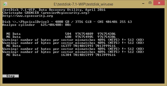

Why have you choosed to recover this partition ?
MS Data 16377 7814015992 7813999616
NTFS found using backup sector, blocksize=4096, 4000 GB / 3726 GiB
If you want to save time, you can manually add this partition after Analyse, Quick Search, Stop. Once this partition has been added, set it to P(rimary), choose Write, confirm, go in Advanced, choose Boot, BackupBS, confirm, Quit and restart your computer.

I did these steps. And no data :(
I repeated these steps for another partition: 16384 7814015999 7813999616
And nothing. Again :(
