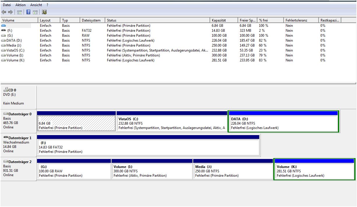

Now I also took a look at the status of the partitions with the Windows Vista Partition manager.
(I am running Vista on my laptop) I thought that the status I can see there might be the status of the partitions I should assign to the Partitions in Test Disk. Is that correct?
When taking a look with the Partition manager I also saw that the damaged partition appears as RAW instead of NTFS.
- Here is the screen of the partition manager
- Partitionen Ansicht.JPG (150.8 KiB) Viewed 5687 times

Re: Partition wants to be formatted
Your current partition table is almost correct.
http://forum.cgsecurity.org/phpBB3/down ... php?id=389
Except your second partition "volume" is an active partition and bootable.
But it's nothing to take care of.
That's why, there is no reason to change/write anything to your partition table.
Your first partition appears as RAW.
But your boot sector is valid.
It indicates that your file system is damaged.
In your case, it would be advisable to copy both folder "backup and documents" to another intact disk or partition.
