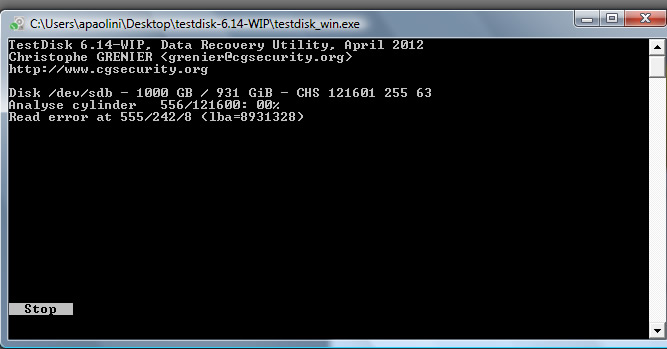

Ciao Rem,
thanks for Your suggestions...
Now another problem; it didn't recognise any partition; I'm waiting the end of the scanning...

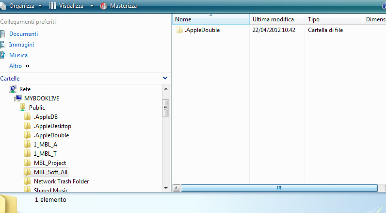

Another question: hoping It will find the partition, Your suggestion was to "copy"; I have bought a WD MyBookLive; how I can do "paste" my data info? Simply open from Windows the folder?
Thanks
Antonio
for information somethimes I'm hearing strange sound in the HD; anyway it's continuing...

Re: External Hard Disk WD - No Partition is bootable
Stop the scan, there are read errors, that may be because of hardware failure.
In the first attep, you were able to found your partition. At that point with "P" keybord key you should be able to list your fils inside testdisk. There's an option to copy from testdisk (windows won't be able to read your linux filesystem), and you'll be asked for a destination.
If your hard drive is failing, you really should begin with a bit to bit copy. It's sometimes not easy when there are many bad sectors.

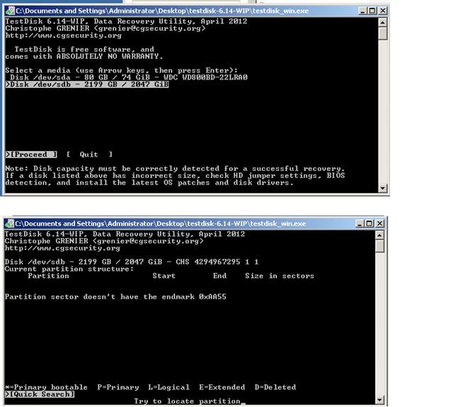

Ciao Remy,
I have to be onest, I'm a bit worried and I think the HD is arriving at the "end"... Anyway...
The strange thing is that the Wd Hard Disk is about 1 TB and as You can see in the image now it became about 2 TB.
Other strange thing is about the partitions: now there are no partitions and it need "endmark"; any advice?
Thanks.
Antonio
I agree with your diagnostic, that's why it would have been better to do a bit to bit copy of your disk. If it founds 2tio instead of 1Tio it's else because it has a firmware corruption, else becasue it can't read correctly the size (probably 2nd one, because of hardware failure).
The "endmark" message is because testdisk look for a magic code at the end of the first sector : 0x55AA ont the las two bytes. If it can't read the first sector, it can't found the code. Do you have a professionnal in datarecovery in your area ? Where are you from ?
