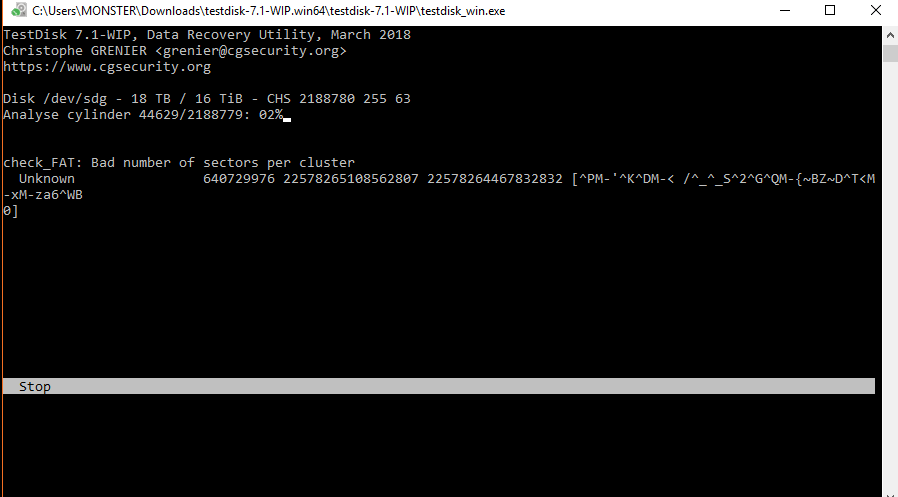

It is a Raid5. This is where I am at with it this morning.
Screenshot (17).png (22.29 KiB) Viewed 5823 times

So Windows decided it needed to update and restart so I lost 24 hours of scanning. But, this time I selected the Intel/PC option and it is zipping right along with the scan!

In the worst case, you always try PhotoRec but don't format.
Big volume are usually using EFI GPT, not PC Intel partition table.
